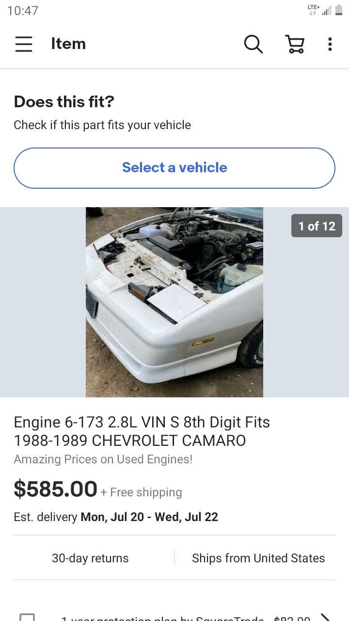

Will a 1989 2.8l Firebird engine easily install in my s10 Tahoe Blazer? I can't find used engines for my s10 blazer easily, but I did find a Firebird engine and I need to know all of the following, what needs to be done for a 2wd engine to go to 4wd "is it just the torque converter ??" If the engine would install in my rig would everything hookup exactly ? I'm not a mechanic , but I try to do my own things

My bad, it's Camaro not firebird . Does this make a difference in what you told me ?

Nope, only real difference between them is the badges and some trim.
