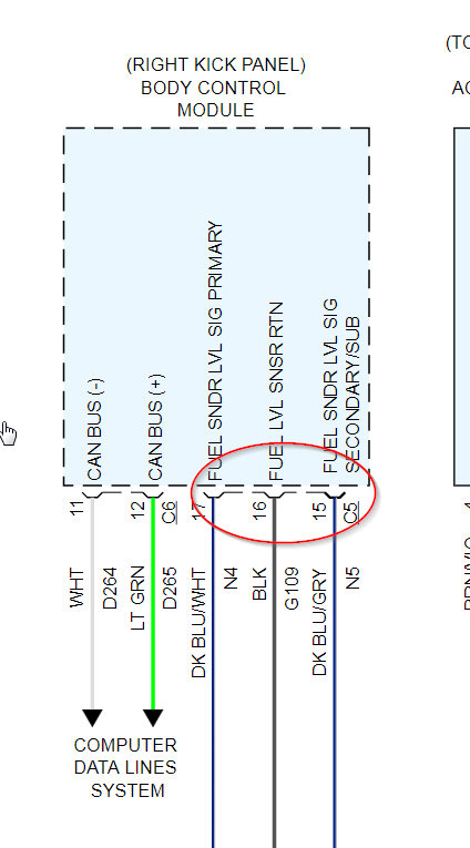

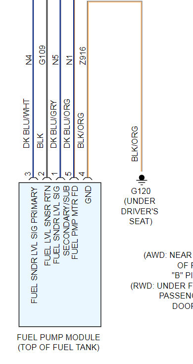

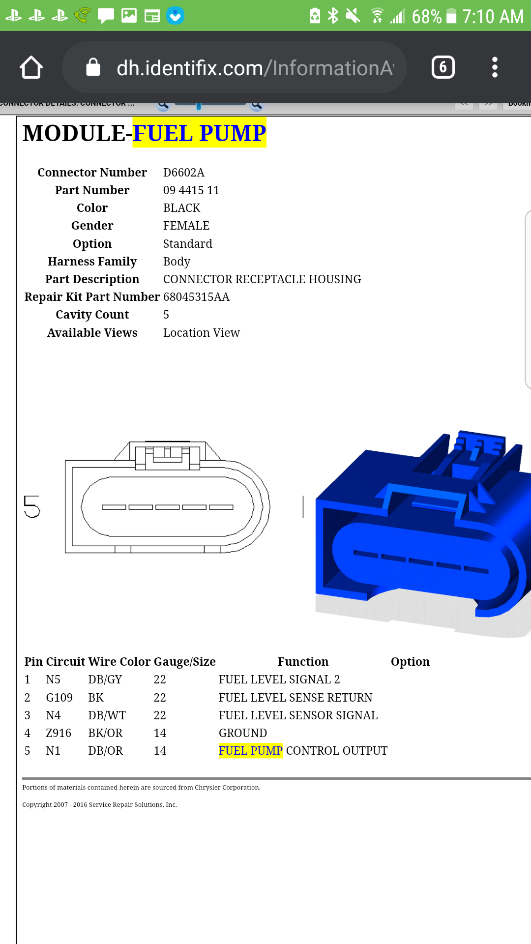

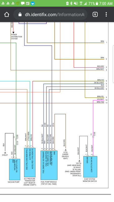

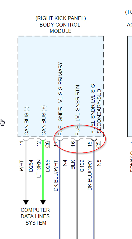

I have the car listed above and it came in as a no start. sprayed a little starting fuel and she started right up and died immediately, checked fuel rail pressure and of course had 0 psi . after this I continued to check for power and ground to the fuel pump and everything checked out to be a bad fuel pump . After replacing the fuel pump the pump still did not run . I then again made sure the fuel pump was good by supplying power and ground. the new pump was functioning perfectly. Here is where it gets weird: i proceeded to connect the fuel pump as normal and test the wires directly at the fuel pump and to my surprise the ground was not being supplied. I checked to see which pin from the new fuel pump module was in charge of giving the fuel pump ground. On the new fuel pump module Pin #3 is connected to the ground side of the fuel pump . In the wiring diagram below Pin #3 on the wiring harness of the car should be "Fuel Sender Level Signal Primary" which I believe goes to the BCM Module and then communicated back to the cluster . So I added my own ground to the #3 DB/WT wire on the harness and she finally started ! But now the fuel level on the cluster shows the gas level being completely empty regardless of a fuel gas tank . So my question would be , did this aftermarket fuel pump need to be rewired to function properly with the car ? In my opinion i thought the black/orange would be the fuel pump ground signal.

You are correct. It appears they wired it wrong. Pin 5 should be your 12 volts and 4 is your ground. If you grounded Pin 3 then this is why your fuel gauge is not working because this is your primary signal wire. Pin 1, 2, and 3 all go directly to the BCM and are basically a 3 wire sensor that the BCM uses to determine fuel level. The BCM then takes this information and sends out over the CAN bus to the cluster to display. This means none of these three wires should be grounded. The BCM will handle this internally. However, if you added your ground to pin 3 I suspect you have an issue with your actual ground on pin 4 if this is what you did and the vehicle started.
So if the pump is not wired correctly then either rewire it or send it back and get another one. Then make sure your ground is good under the drivers seat. Worse case, run a new ground from the pump to a good location. Also, a lot of times you can't take those connectors apart without breaking them and if you break it they may not take it back so I would at least run it by the parts supplier and let them tell you to try it.
