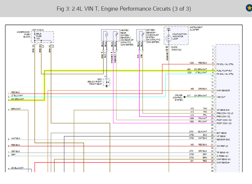

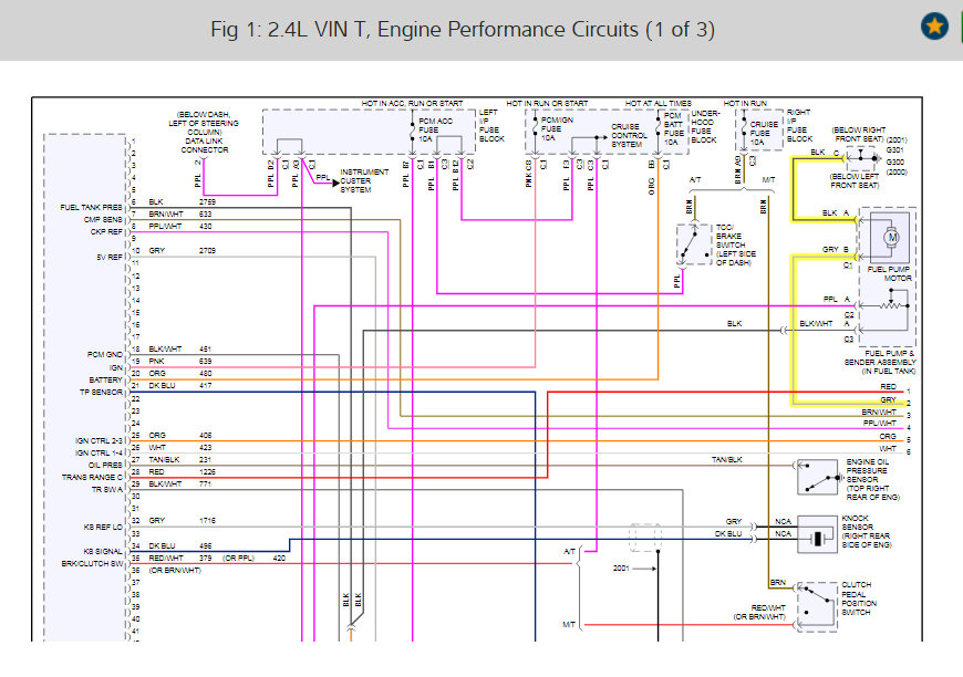

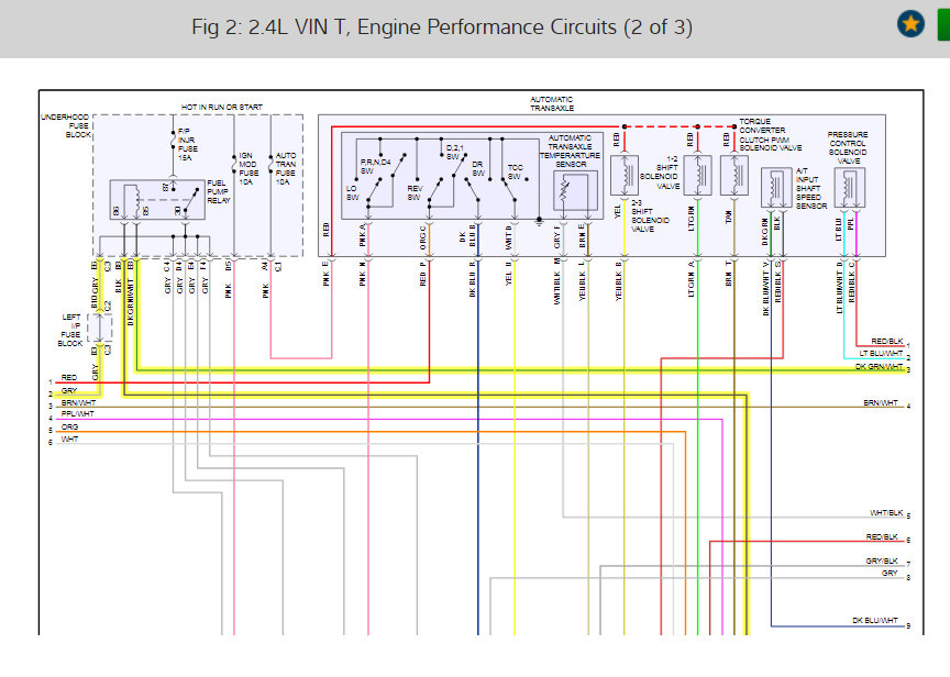

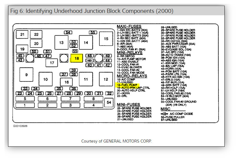

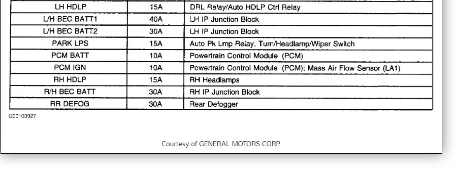

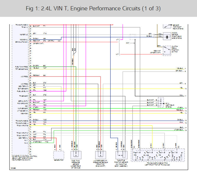

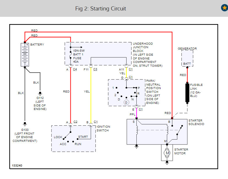

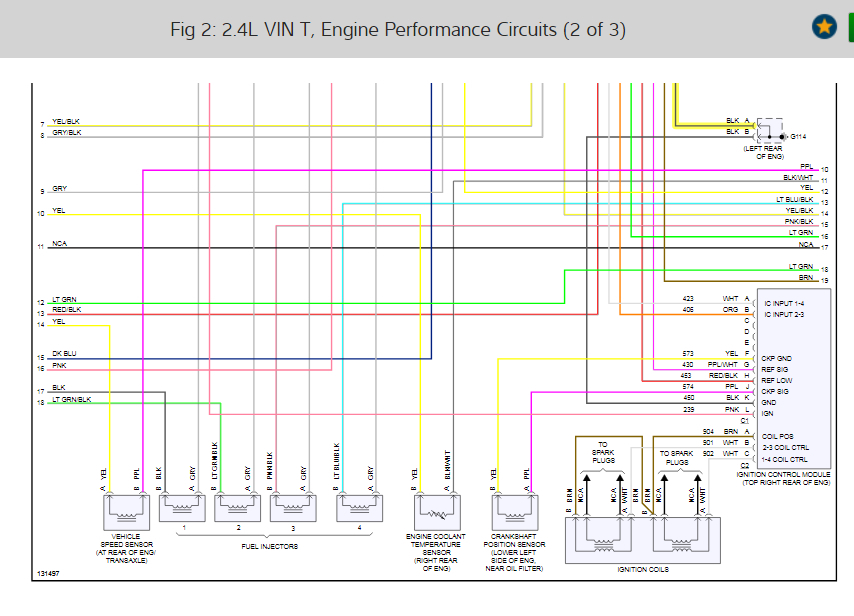

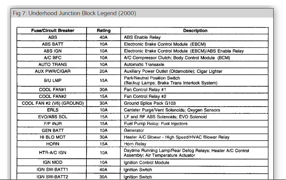

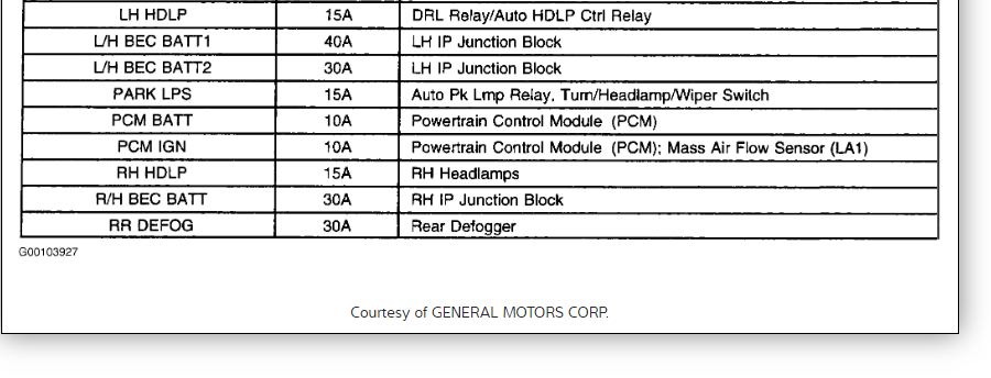

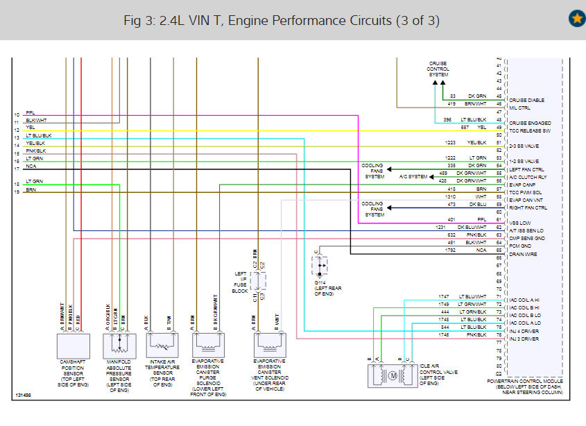

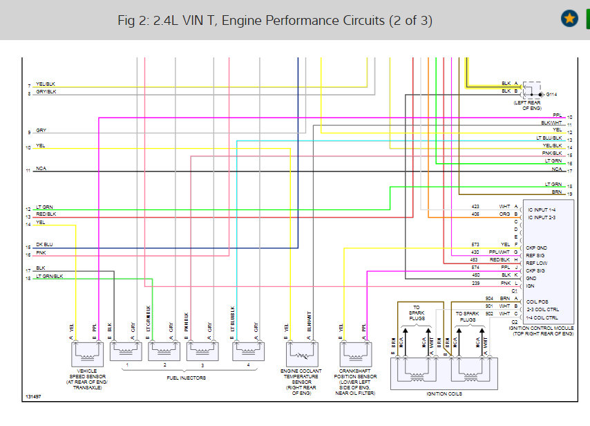

Okay, so your fuel pump is only turning on one out of ten times. Let's see why. I am going to need you you to take a voltage reading at pin 85 of the fuel pump relay with the vehicle's ignition key in the "RUN" position. The fuel pump relay is located in the Under hood Fuse Box. I have included a diagram of it along with a callout, wiring diagrams of the fuel pump circuit along with the starting circuit in the diagrams down below for you. Here is a link on how to use a digital multi-meter (DMM), if needed, below:
Please take the reading and get back to us with what you find out. We will go from there.
