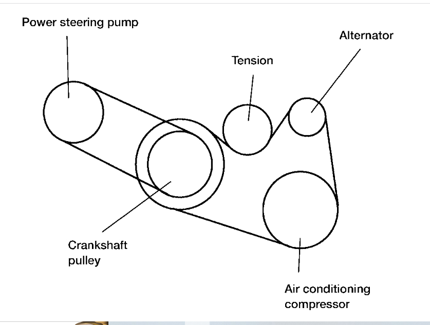

Looking at the belt routing for this vehicle, it appears the power steering belt is separate from the serpentine belt. (see pic below) Is that correct? Also, could you take a few pictures of how it's mounted and upload it for me to see?
See pic below.
