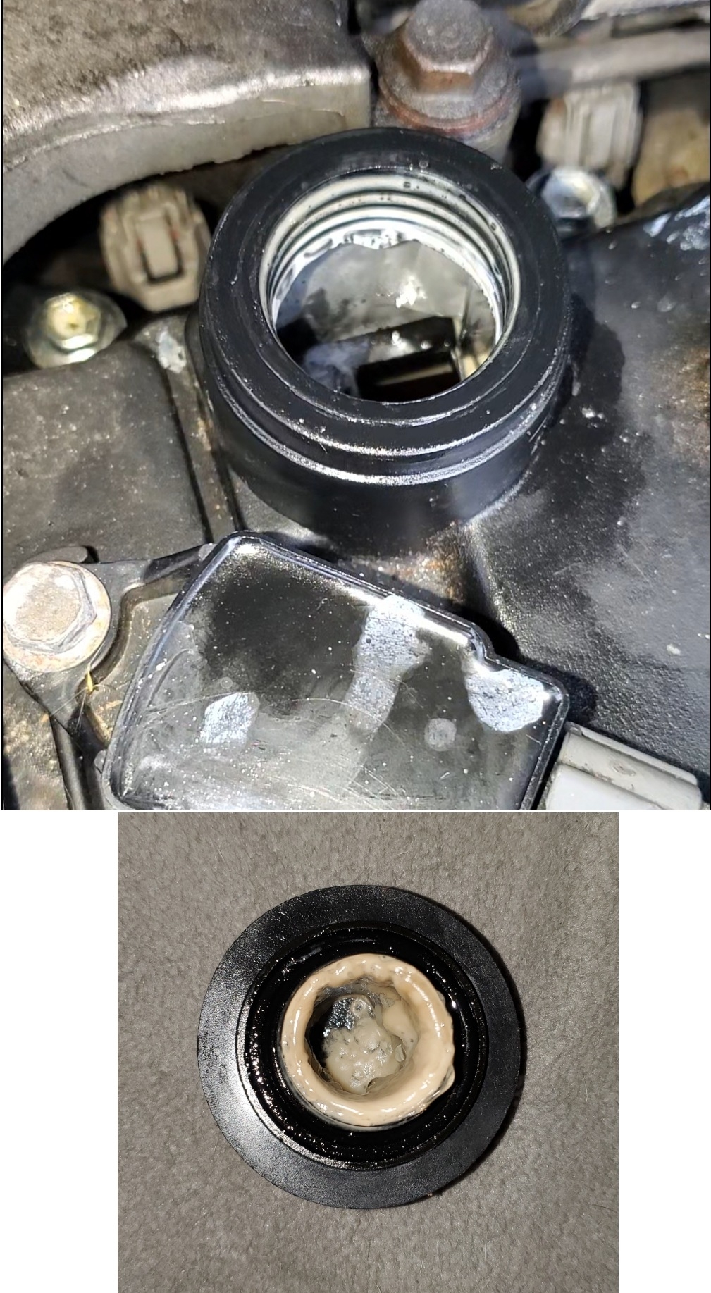

I assumed i had a blown head gasket because my radiator had a leak, and my car ran hot. The next day i changed the oil and filter because it was like chocolate milk and bought a new radiator and Bars Head Seal (Blown Head Gasket Repair). Put that in and topped it with coolant, started the car and let it run with the heat on for 15-20 minutes (until the temperature gauge started rising) and the coolant reservoir was bubbling up and the brand-new oil is chocolate milk looking again. What else can i do to try and fix it?
