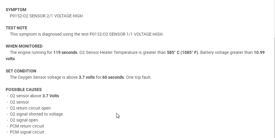

Just replaced the engine last week. Runs and drives fine although sometimes while driving when i press the accelerator car stalls. I have to press accelerator almost to floor.
I have to repeat this several times then car runs normally. Please help?
