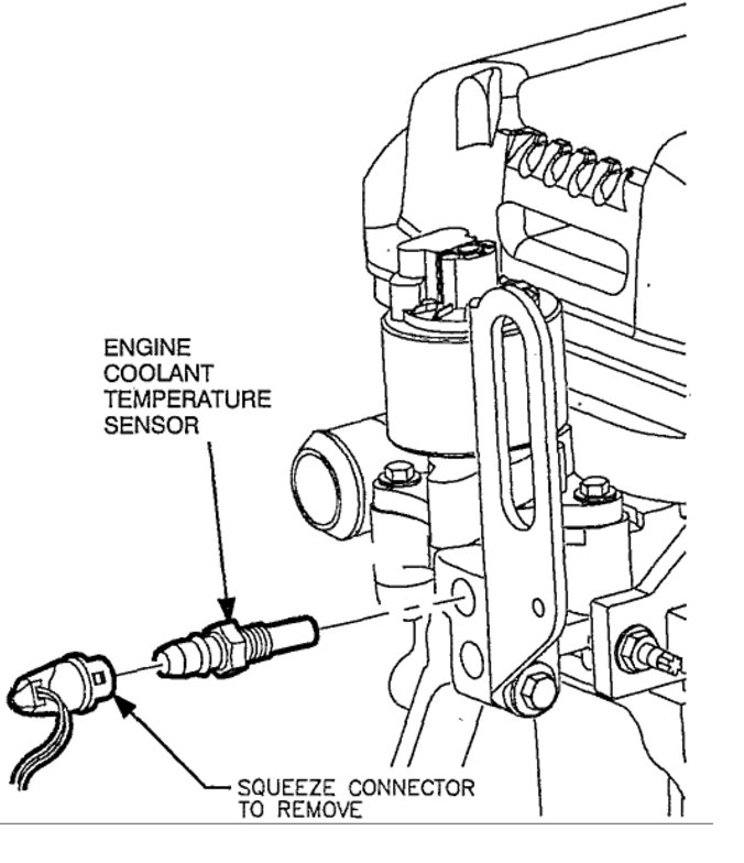

That is exactly what I was going to suggest.
Here is a guide that will show you what you are in for when doing the job.
https://www.2carpros.com/articles/coolant-temperature-sensor-cts-replacement
Here is a diagram of where its at on your car. (below)
Great job on the video BTW
Please let us know what happens, we are interested to see what it is.
