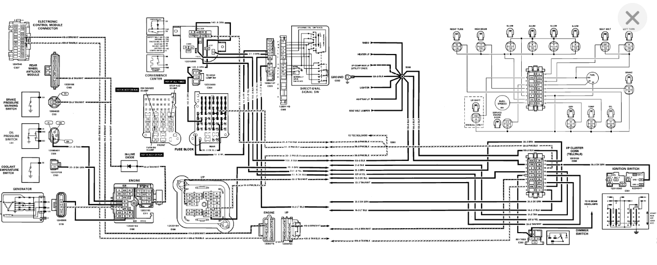

ECM deleted. I ran a new wiring harness (headlights to taillights) I'm stuck on the oil pressure switch though, everything else is on and fine. What wires go where as far as power, ground, and the signal to my digital cluster?

I'm not sure if you are going to be mad at me or glad, I found what I did. LOL Because of the model year, the schematics I have are all OEM and difficult to follow.
I attached the schematic below for the oil pressure switch circuit.
Let me know if this helps or if you have questions.,
joe
See pic below.
