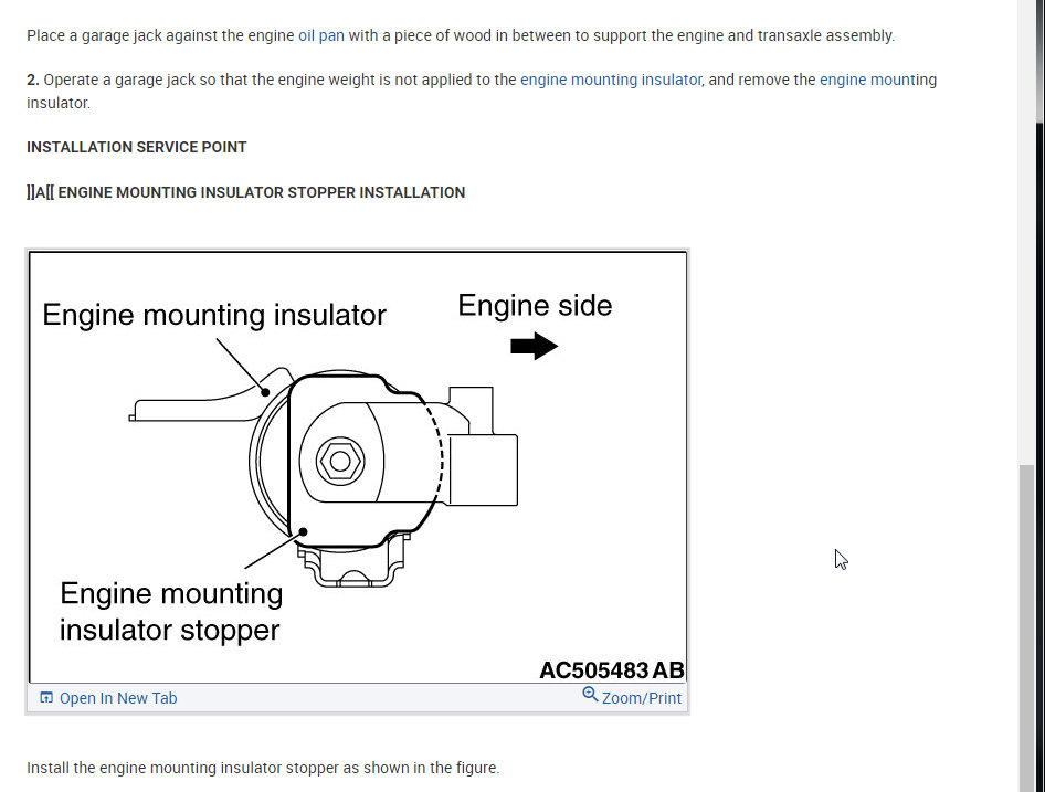

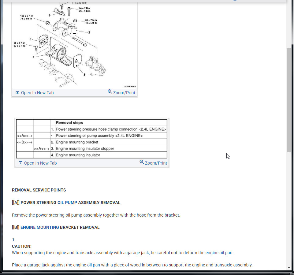

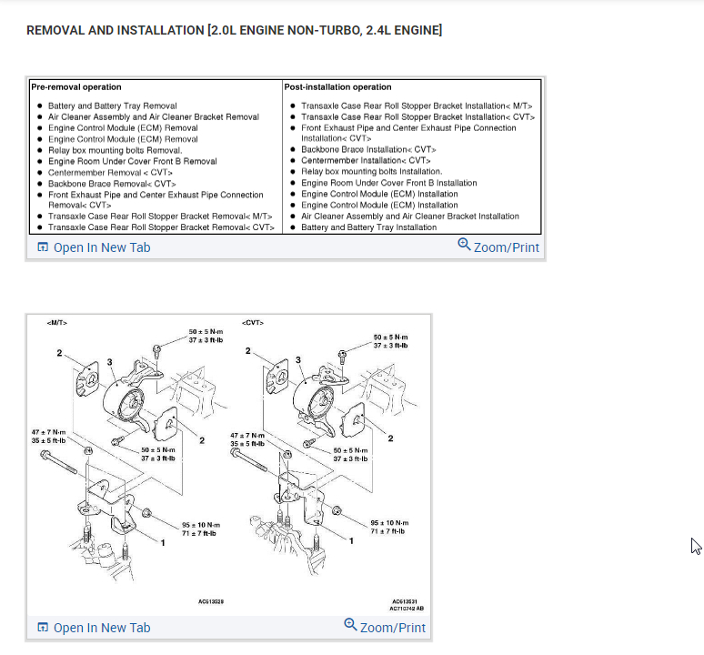

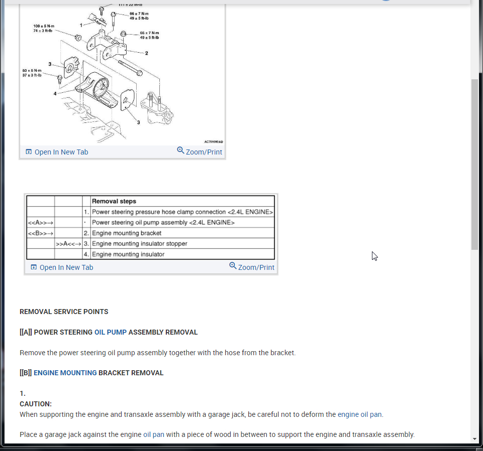

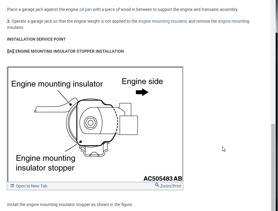

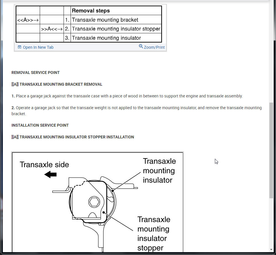

This sounds like it is something in the transmission just based on what you are describing however, it could also be a mount issue. Clearly this would be a better issue then a transmission issue so let's start there.
I am attaching the info on how to replace the mounts but I would just use this to inspect them and make sure they are not grounded.

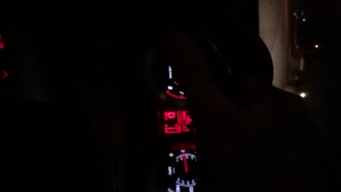

Sorry It took so long for a video but here it is. You can really hear what’s going on at about 1:21-1:24 it sounds like a hard shake or bump. If I have to upload something better I will.
Jan 23, 2021 at 7:07 PM

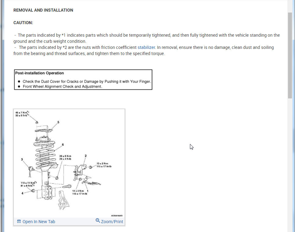

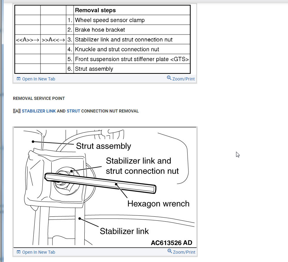

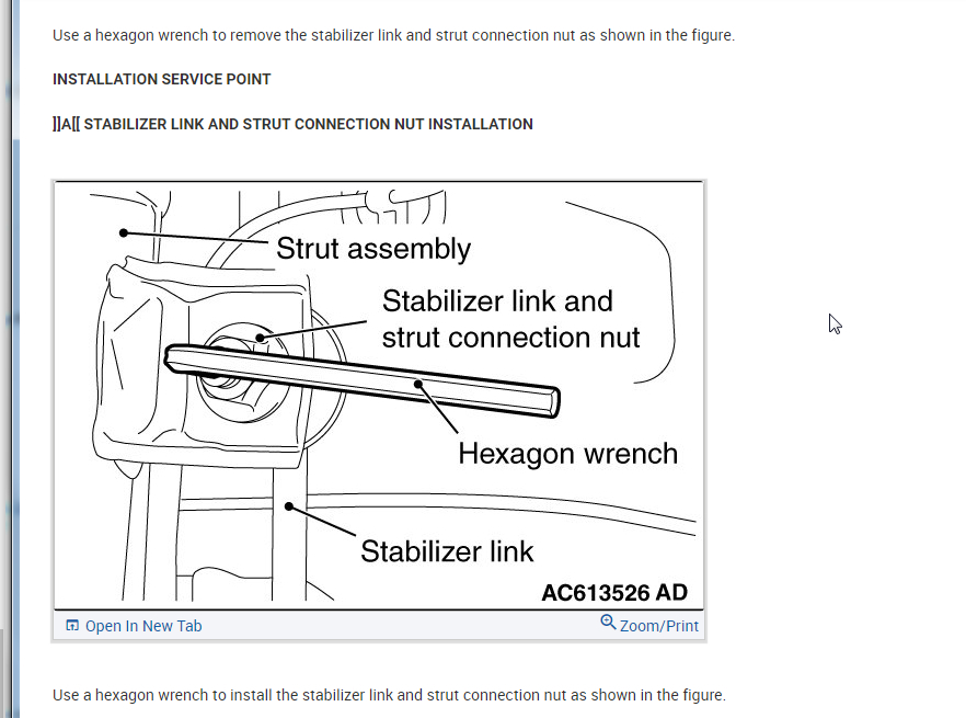

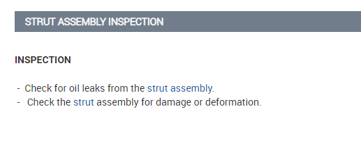

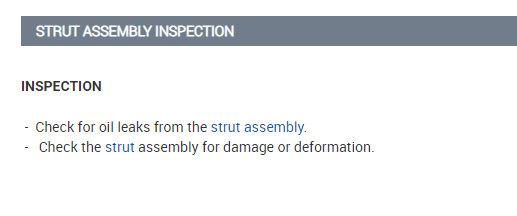

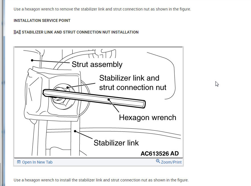

Just to be clear, this is the loud noise when you hit a speed bump or whatever that was in the road? If that is the case, this is the shocks bottoming out and the loud noise is the actual control arms of the suspension hitting the bump stops.
However, it looked like you hit that pretty hard so I am not sure new shocks will prevent that but I would definitely change those first and foremost then make sure there are no broken suspension components.
I included the process below for your review.
