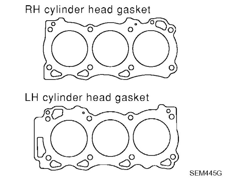

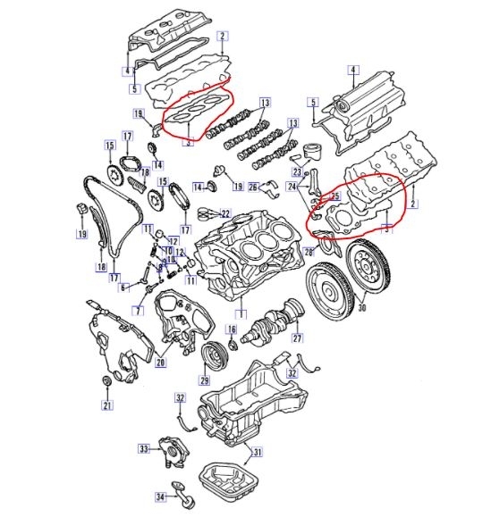

White smoke is usually an indication of burning coolant from a failed head gasket.
https://www.2carpros.com/articles/white-smoke-or-steam-coming-from-the-exhaust-pipe
A leak down test on the cylinders will confirm this. You can also do a chemical test as well.
The smell may be from a cylinder not burning all the fuel and unburned fuel is in the smoke.
