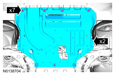

Remove the retainers and the engine front undershield.
pic 1

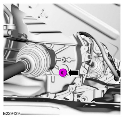

With the engine running in PARK on a level hoist make sure the transmission is at normal operating temperature 85-93° C (185-200° F). Check the transmission fluid is even with the oil leveling plug hole.
pic 2

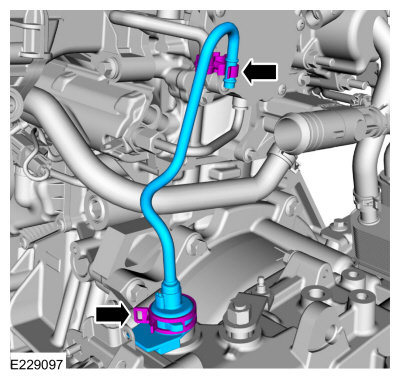

If the transmission fluid is not even with the oil leveling plug hole, add clean transmission fluid in increments of 0.25L (0.5 pt) until the transmission fluid is even with the oil leveling plug hole.
Material : Motorcraft® MERCON® LV Automatic Transmission Fluid / XT-10-QLVC (MERCON® LV ) (WSS-M2C938-A)
Pic 3
Install the oil leveling plug.
Torque : 26 lb.ft (35 Nm)

Install the engine front undershield and the retainers.
Pic 6
