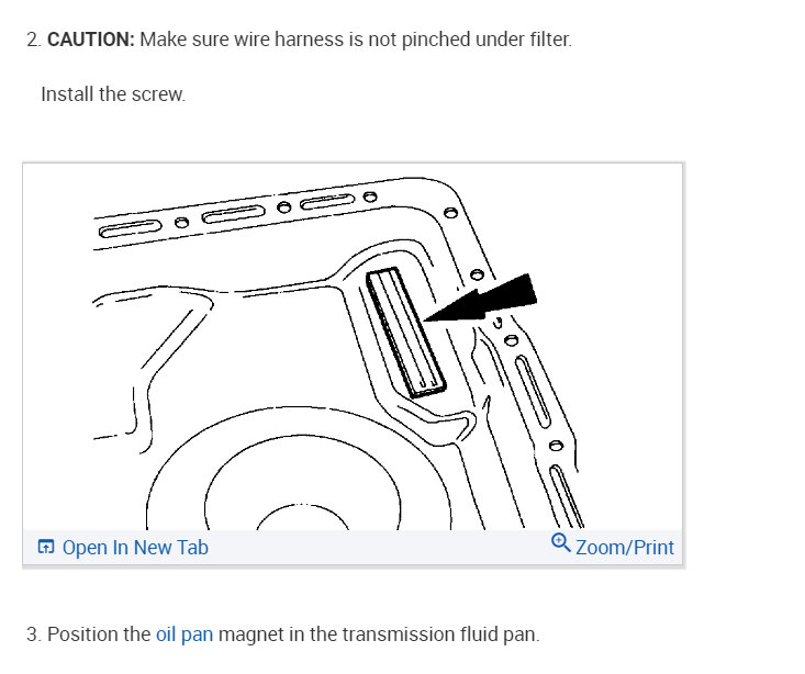

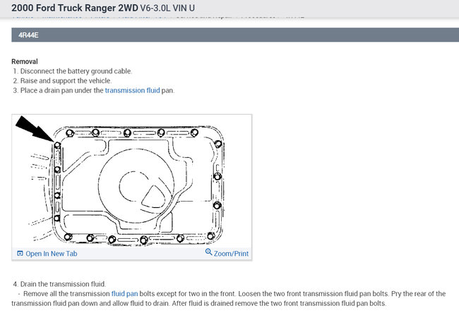

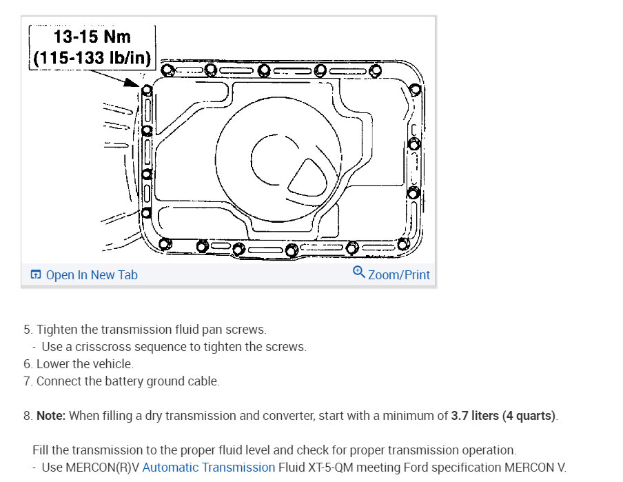

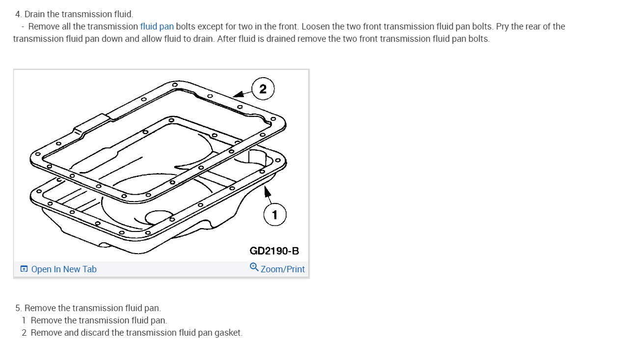

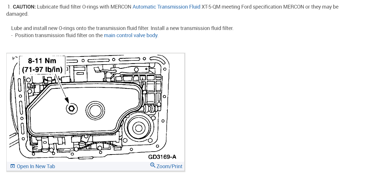

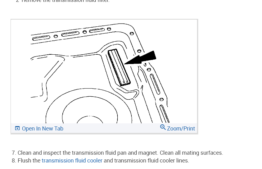

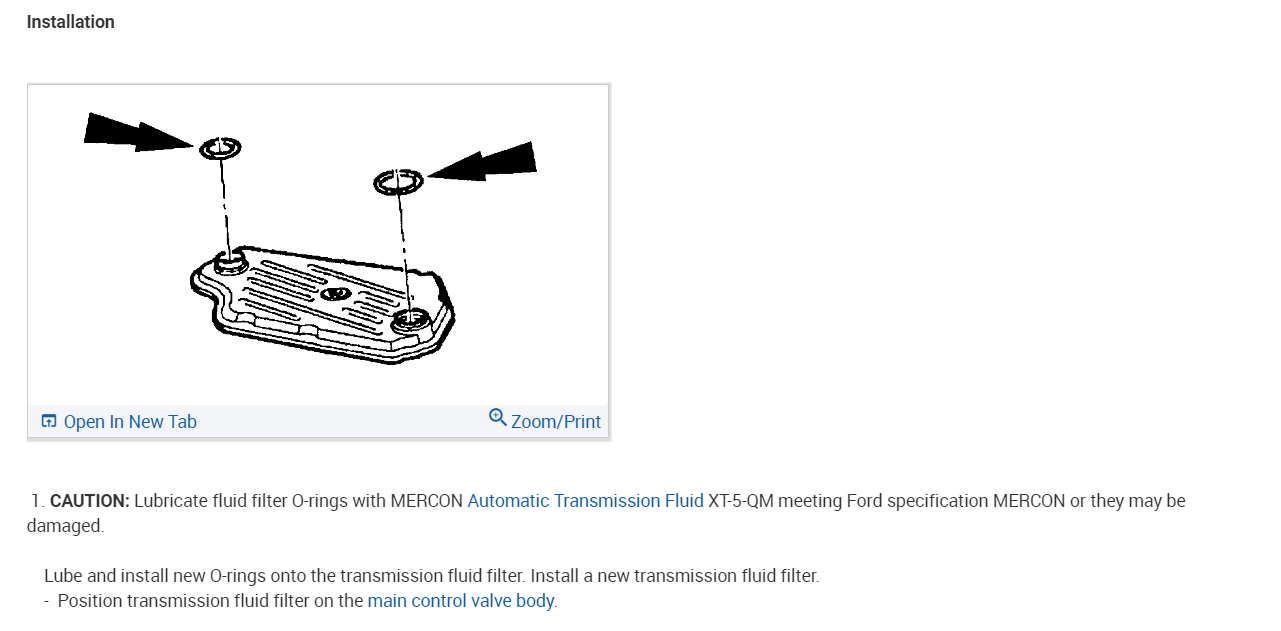

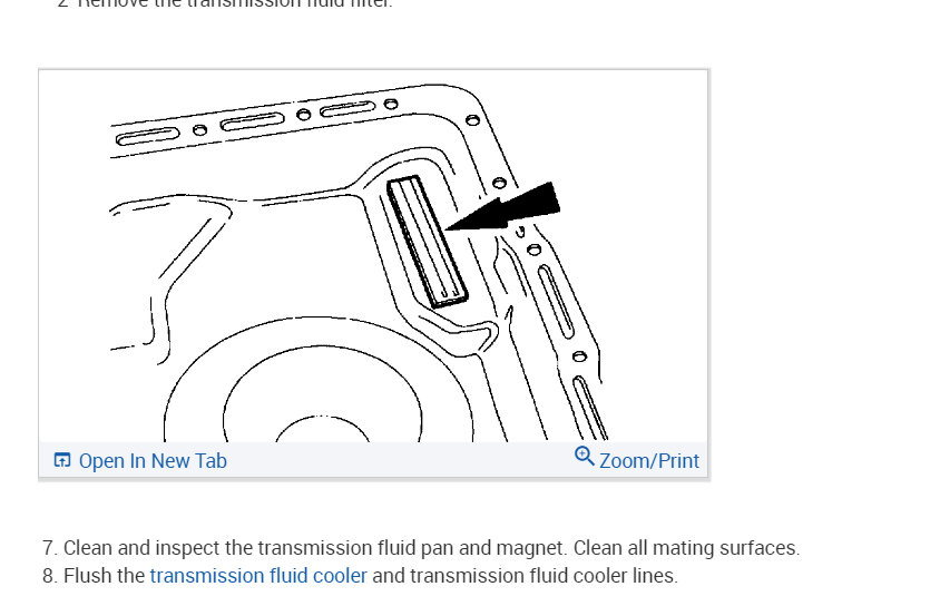

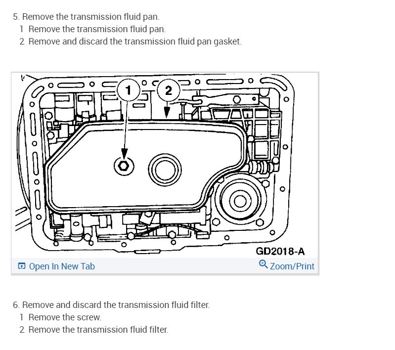

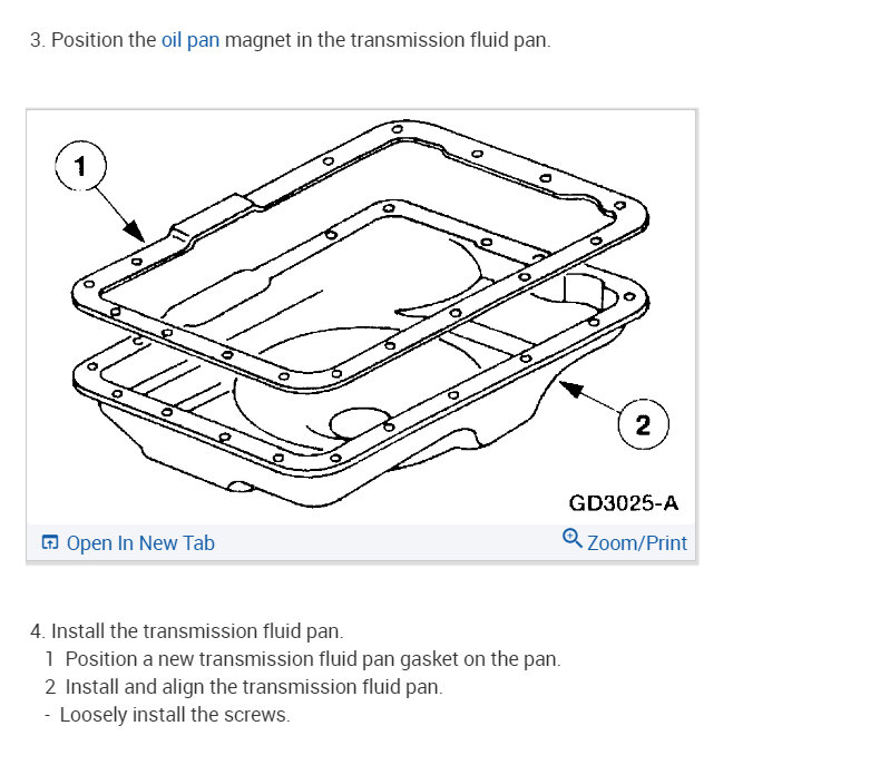

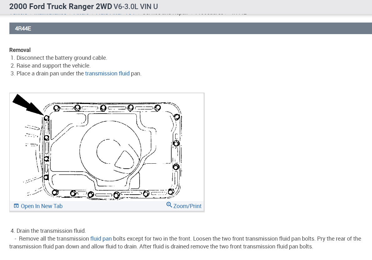

It sounds like you have a clogged-up transmission filter, but to be sure can you upload a short video of the issue so I can hear it? Here is a guide that can walk you through the transmission service with instructions below to help you with your truck:
This guide can help as well:
https://www.2carpros.com/articles/automatic-transmission-problems
