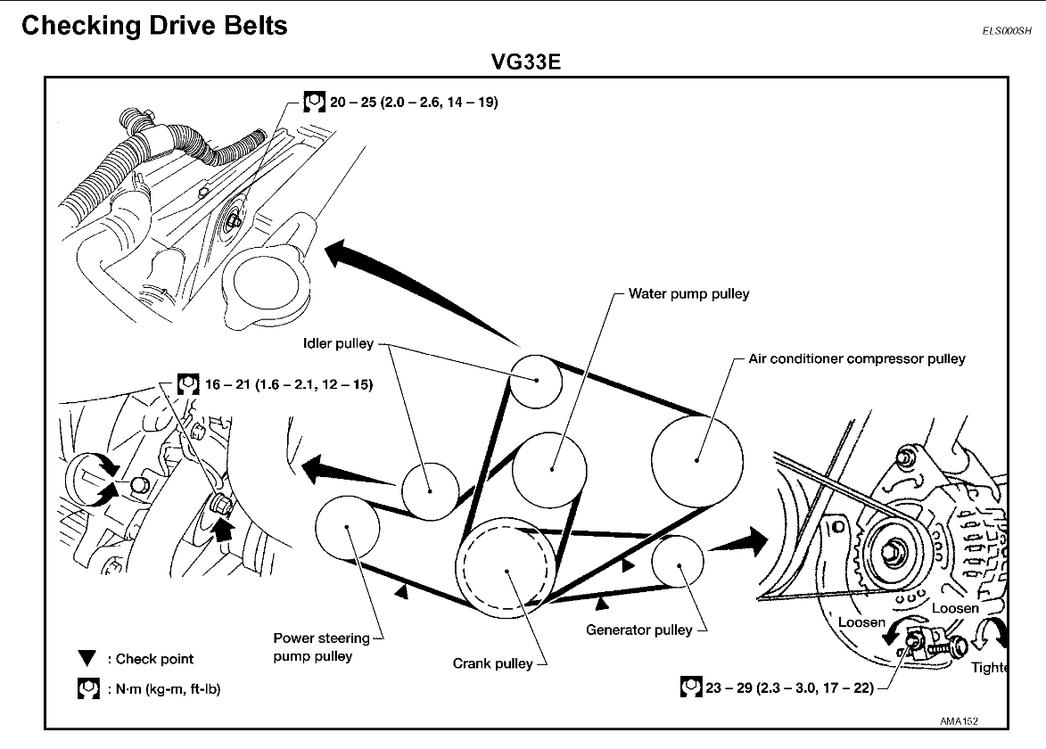

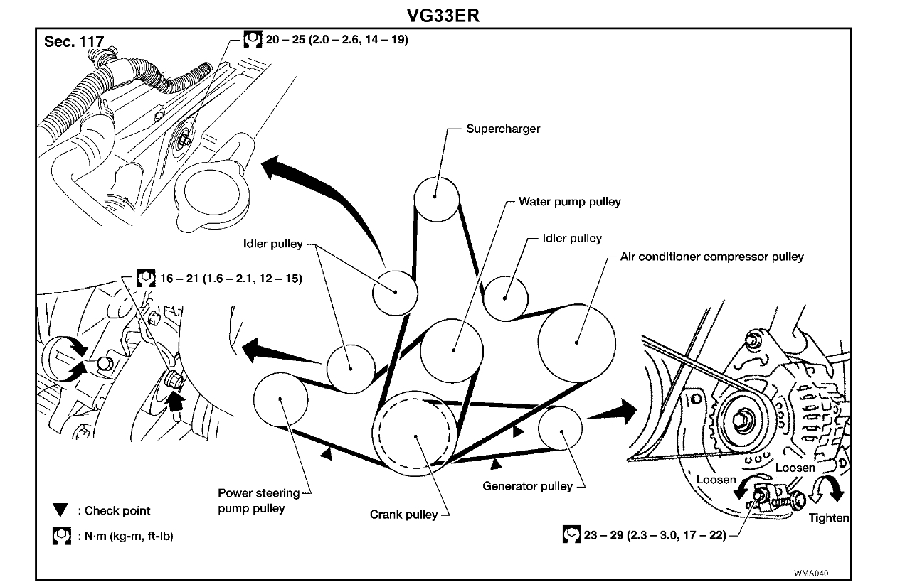

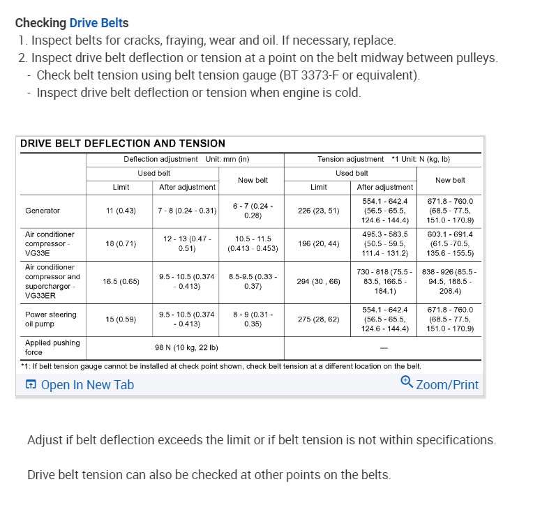

The car is heaving, like huff, huff, huff. Whining squealing when accelerator is pressed
May 30, 2022 at 2:54 AM
This is common when the engine's serpentine belt is loose or worn out but to be sure can you upload a video of the engine making the noise in the meantime here is a generic guide on how to replace the belt with specific instructions for your car in the diagrams below.
https://www.2carpros.com/articles/replace-serpentine-belt
and
https://www.2carpros.com/articles/car-squeaking-noise
