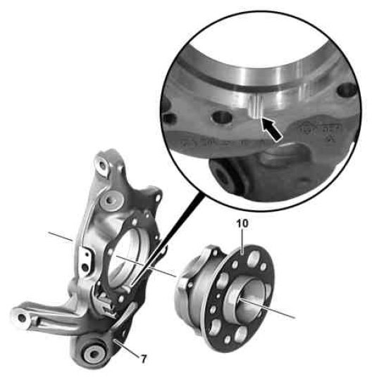

What was actually replaced? If it was the axle, the hub bearing may not be tight enough or too tight. What I want you to do is this. Drive the vehicle in a safe area. While driving, safely turn left and right to see if the tone of the noise changes. I have a feeling you have a problem with a hub bearing. If you turn left and the noise gets louder, the right front wheel bearing is the problem. This works the opposite, too.
I attached a pic of the hub bearing that I am referring to. See Picture 1.
If you determine this is the problem, here are the directions for replacing the hub assembly.
Let me know what you find.
