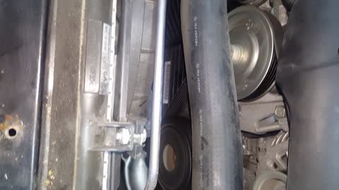

I started the car and it threw p0102 and p0113 codes it also made a medium to loud volume, high pitched, whining noise in the front of the engine bay seemingly by the alternator and pulleys

After idling for a few minutes the whining went away. I changed the oil and drove it to work and on the way it started whining again. I turn the steering wheel and the whining seem to increase in pitch but when I had the car in neutral, and was rolling, it did not whine at all when I turned the steering wheel. The car also seemed to drive fine as far as RPM range.

Can you get a recording of this noise? Then remove the belt and start the engine and see if it is still there.
If so, we can rule out the pulleys.
Let's get the recording so we can get on the same page as you and go from there. Thanks

That definitely sounds like a belt noise. I would remove the belt and see if it goes away. If not, it may be internal but I would bet on a belt/pulley noise.
