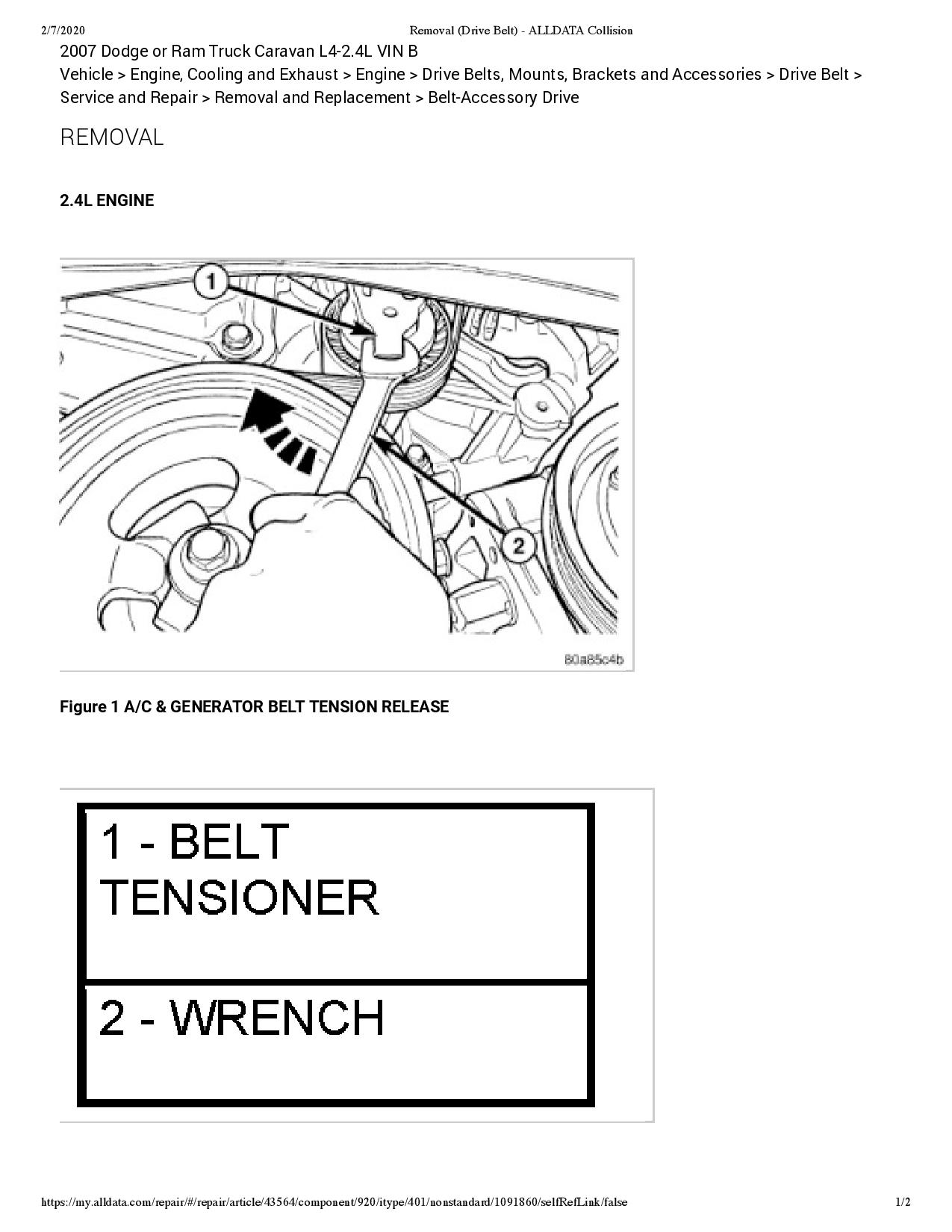

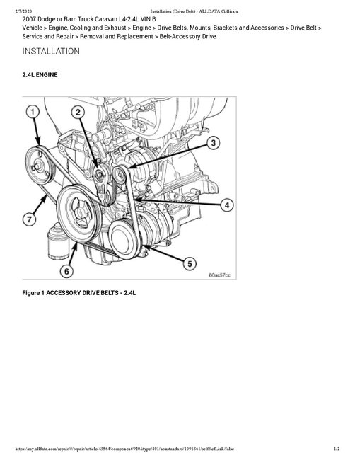

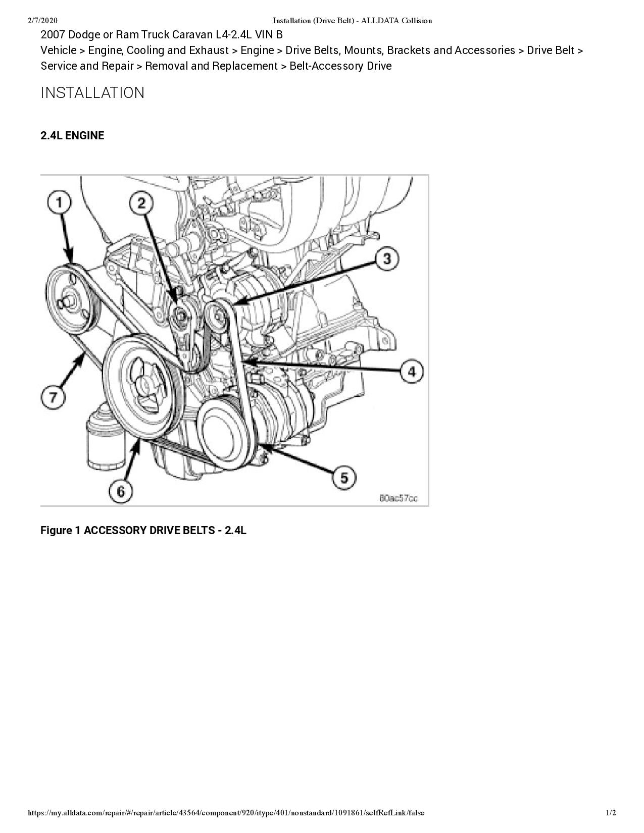

I have attached the instructions for removal and installation of the belt below.
