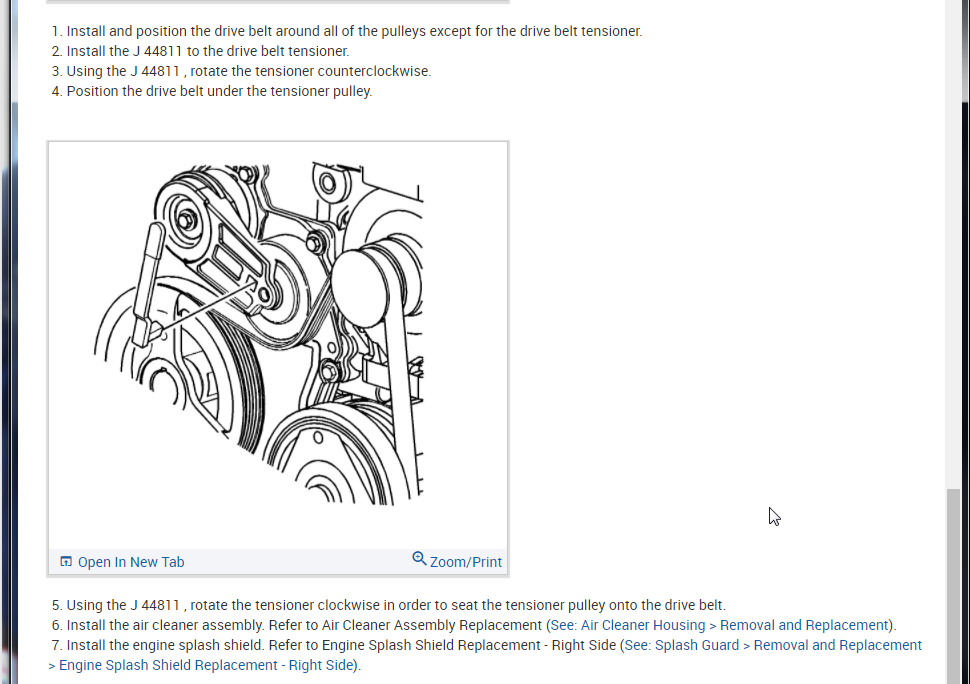

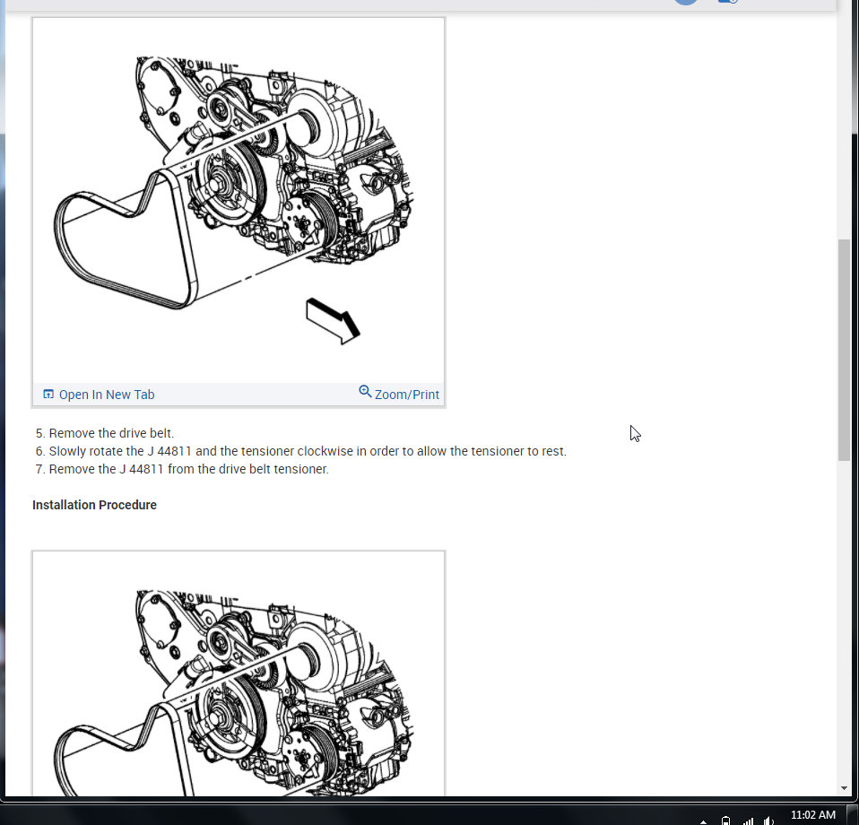

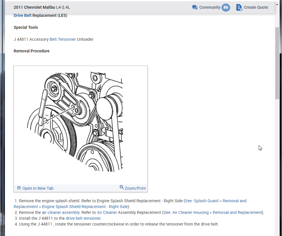

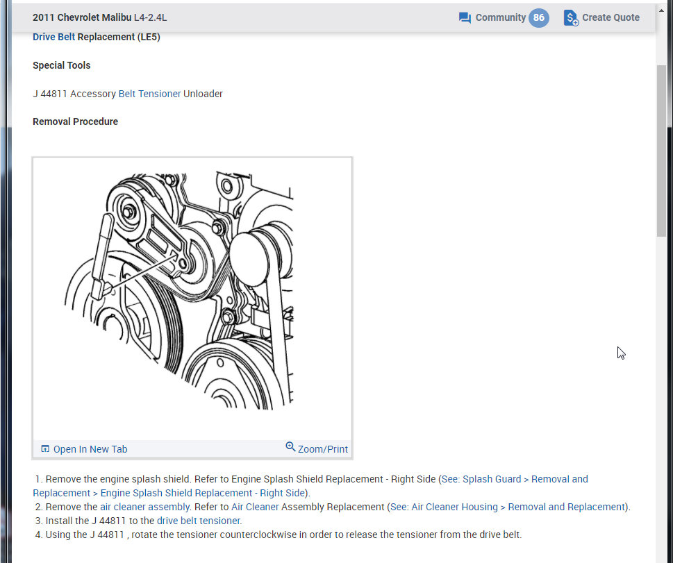

I also attached the info from the manual on how to replace the belt as I would just replace it and then make sure the noise is gone. Let us know what questions you have. Thanks
