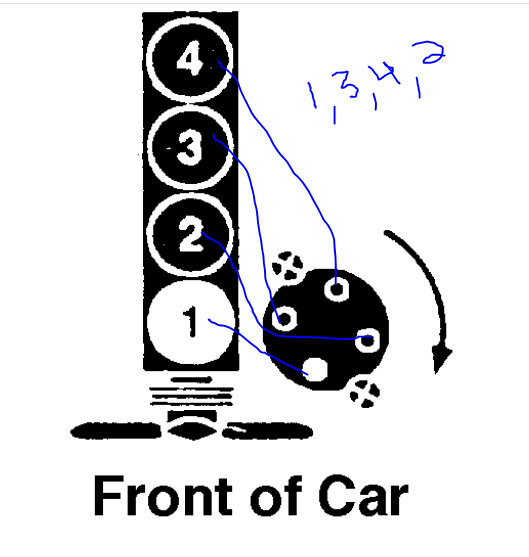

You need the firing order. It is 1-3-4-2. I attached a pic below showing the distributor cap and cylinder locations. I drew a blue line from the distributor to the cylinder where it belongs.
Keep in mind, I am basing this on the idea that the distributor wasn't removed and is still properly installed. If there is something different, let me know.
joe
See pic below.
