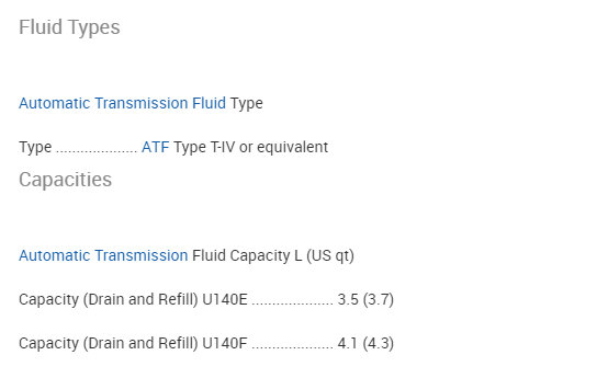

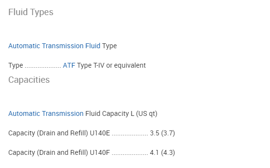

Looking for a recommendation. what's the best choice to make when replacing transmission oil?
Jan 20, 2020 at 10:54 AM
I attached the specifics about the fluid and capacities.
Let me know if you have questions. Thanks

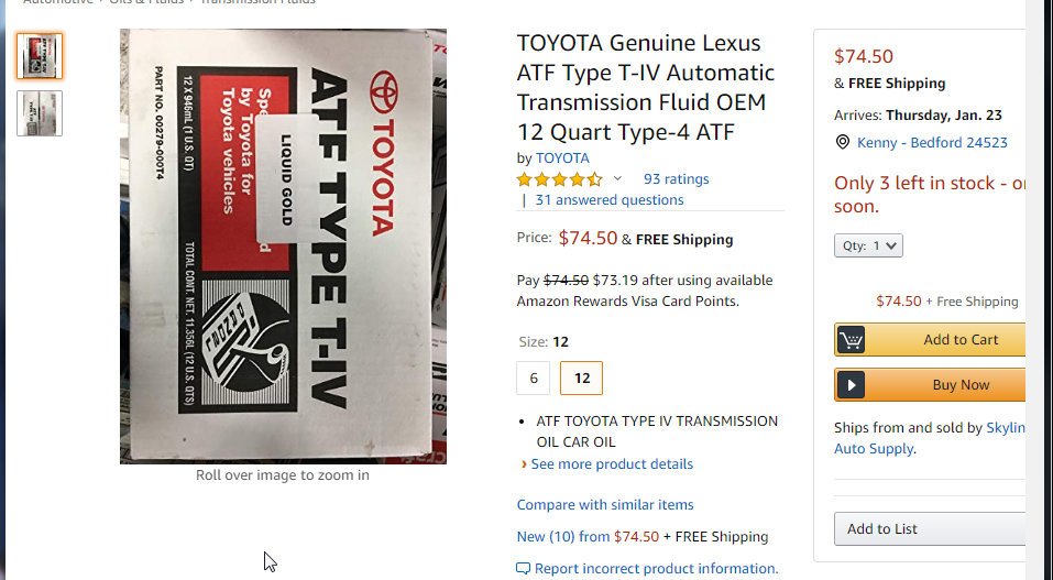

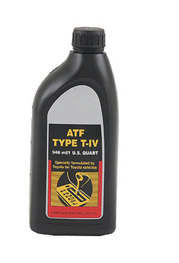

Your unit takes a specific fluid called Type T-IV. Many say that you can just use a Dextron alternative but the link below gives a pretty good price.
https://www.amazon.com/TOYOTA-Genuine-Automatic-Transmission-Type-4/dp/B00EV5A5NC
If it were me, I would stick with the OEM fluid just because it is not a common ATF. I am sure you can find alternatives but again, unless they say they are direct replacements I wouldn't use it and I have not found one that says it is.
