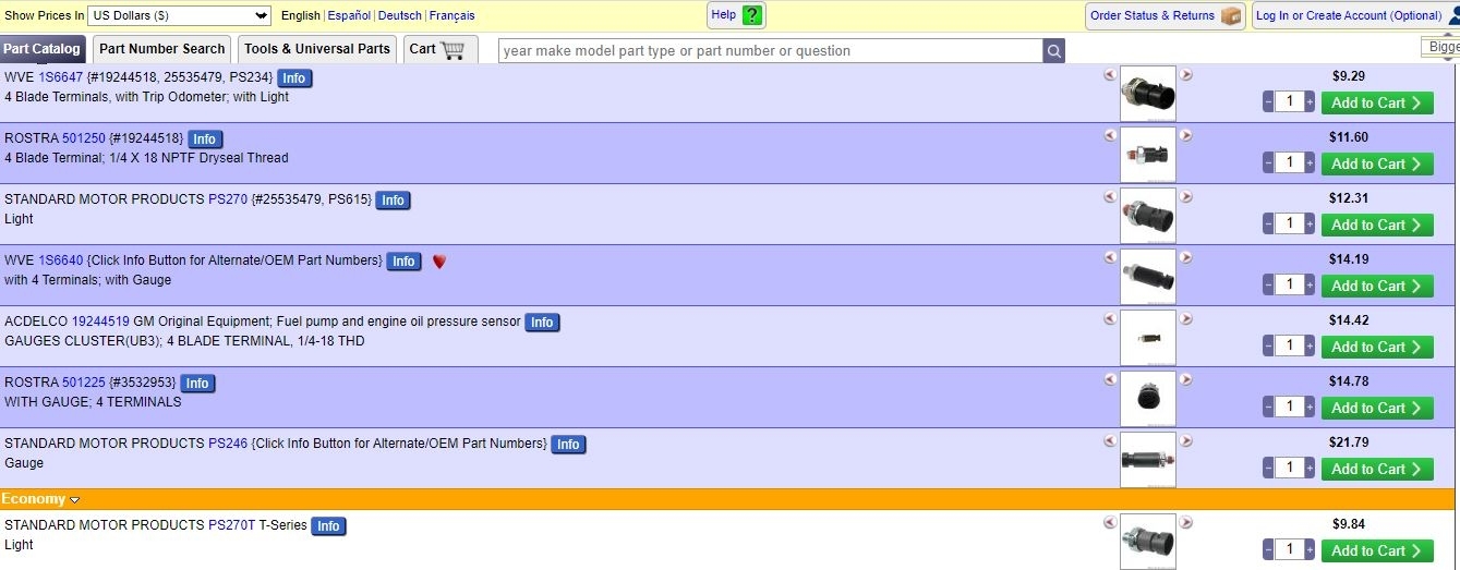

I need to change my oil pressure sensor... Went to RockAuto, they have GM 19244518 and 19244519 sensor... Which one is the good one? On Google they say it's the second option but they also said UB3 cluster option?! I'm lost

The difference is whether you have a gauge or a light for the oil pressure reading.
I attached the picture from Rock Auto and the difference is either a light or a gauge.

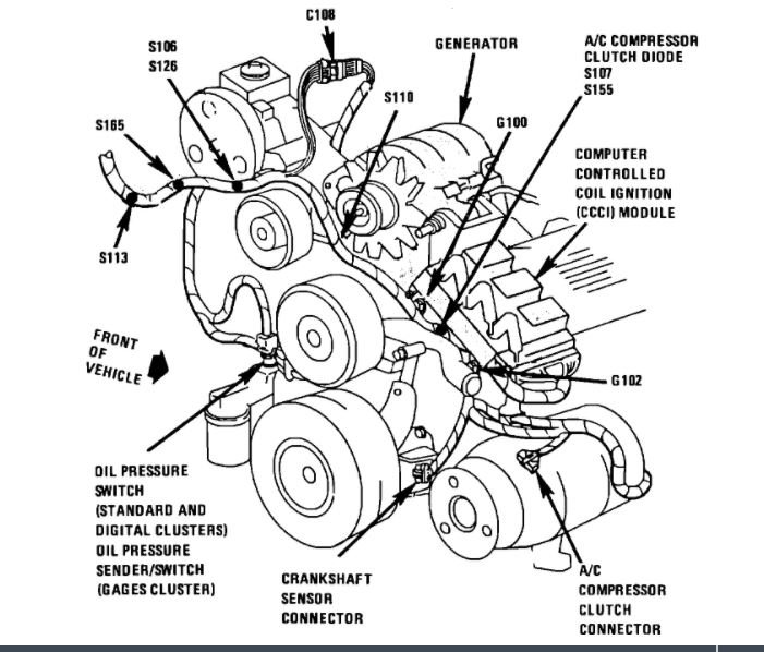

I attached the location of the sensor for you as well. I also attached a YouTube video on replacing the sensor.

I understand now... What about UB3 cluster ? Is my instruments cluster UB3?

Do you have the digital cluster?
Oct 14, 2020 at 3:40 AM
FRAGO
  • 32 POSTS
It's an electronic one but with needles...
Oct 14, 2020 at 3:45 AM
Okay, you do not have that option. that option is digital only.
