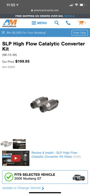

I have a straight piped car listed above GT model. I need to pass emissions and remove my check engine light. I’ve been looking at SLP high flow catalytic converters, but I don’t know if that’s the way to go. any insight or other options? I love how loud it is, but I also get a hiccup that throws me around in first gear and I’m thinking it’s back pressure.

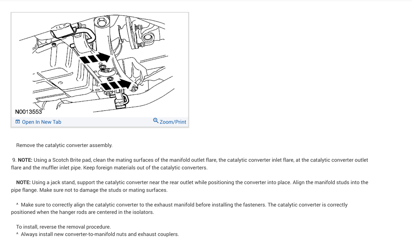

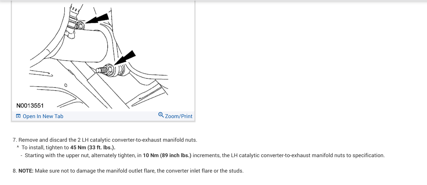

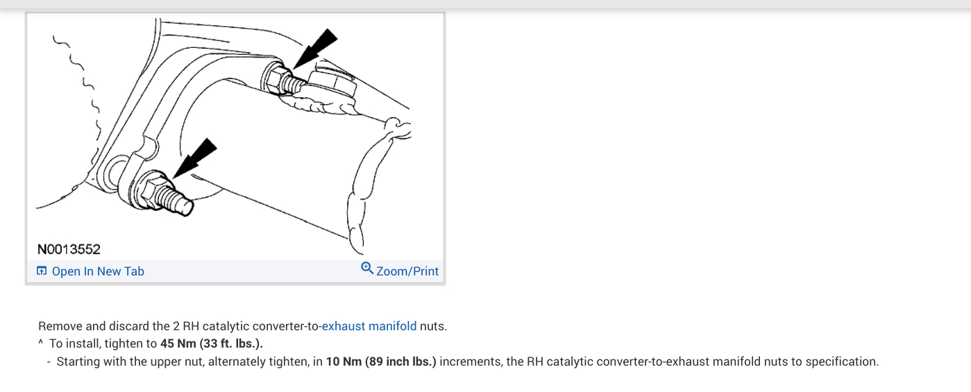

SCGRANTURISMO
  • 4,897 POSTS
Hello again,
These two DTC's are DTC's for both of your vehicle's catalytic converters being worn out. P0420 is for bank 1 and P0430 is for bank 2. Here is a generic guide for changing catalytic converters below:
https://www.2carpros.com/articles/catalytic-converter-replacement

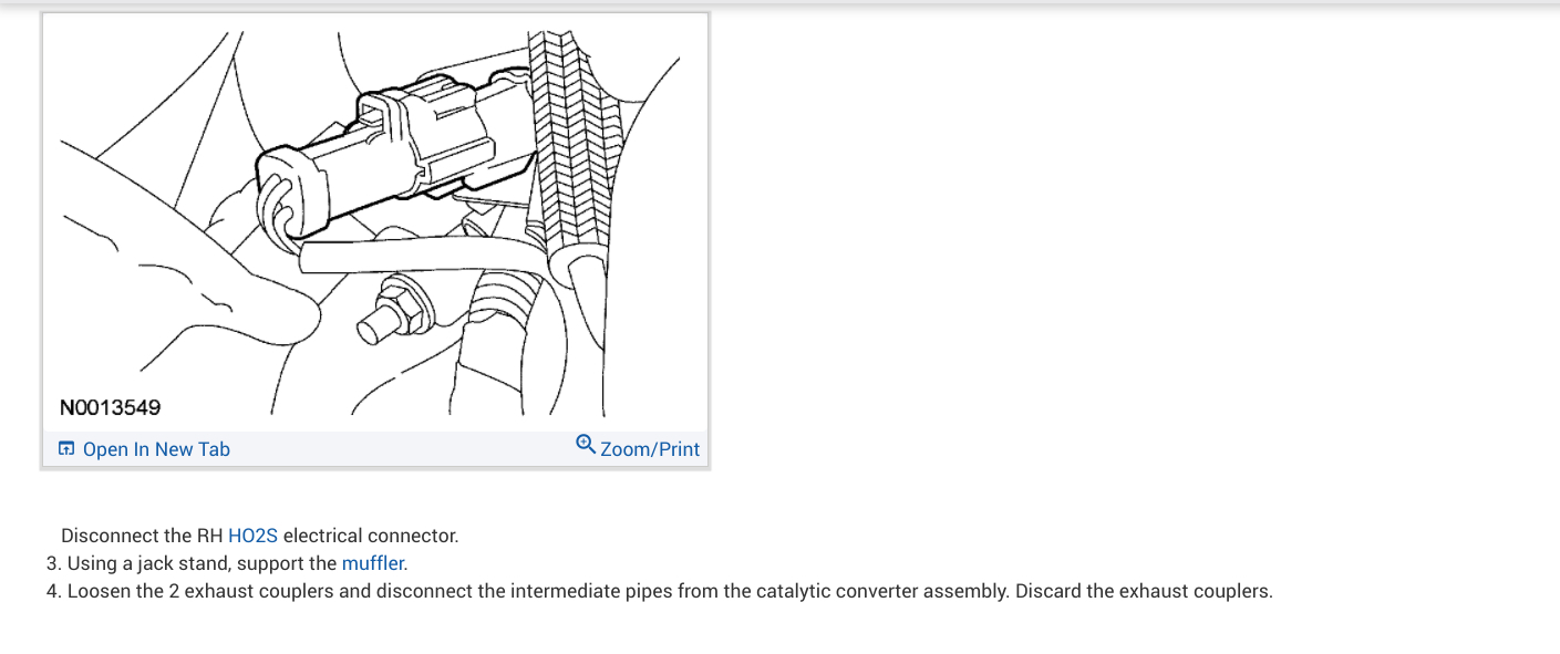

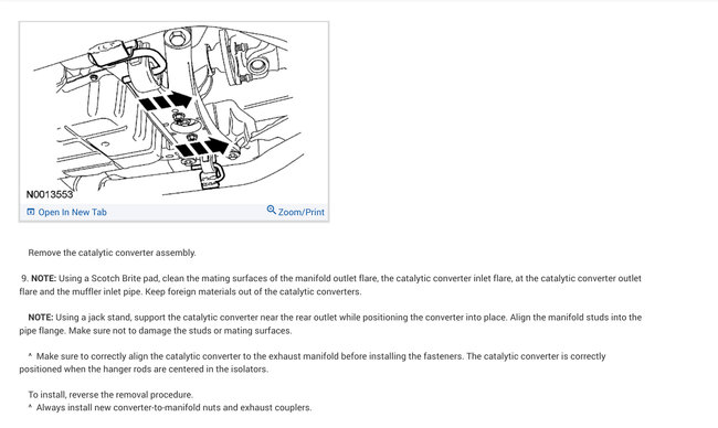

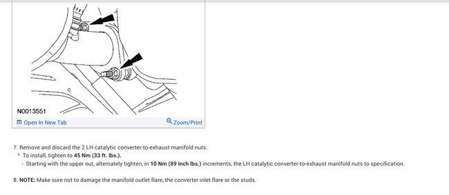

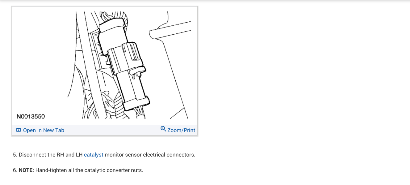

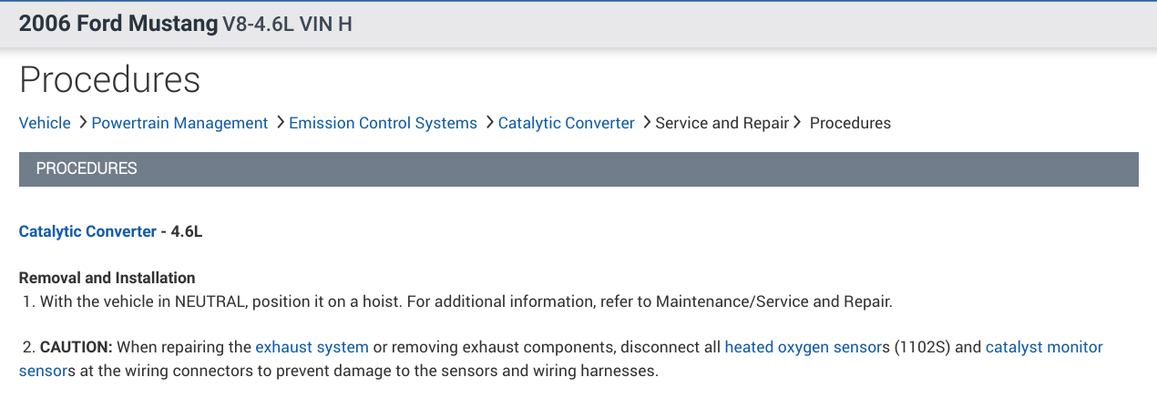

In the diagrams down below I have included a guide from the vehicle manufacturer for the replacement of the catalytic converters specific to your vehicle. This, however, probably isn't going to relate to the problem with 1st gear hesitation unless they are plugged, but that would cause loss of power, period, and engine overheating. Is there any way that you could take a short video of whats going on when you take off in 1st gear for us and upload it so we can see exactly whats going on?
