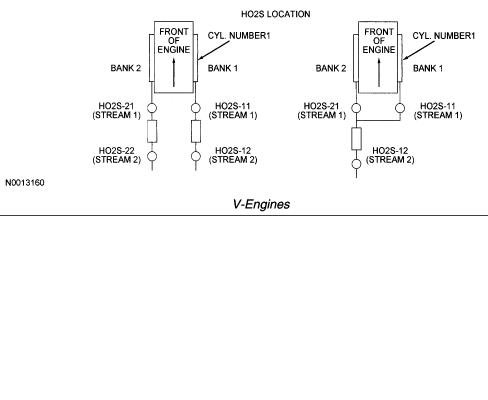

Which catalytic converter to change codes P0171, 174, 430, 300, 303, 305? Replaced spark plugs not sure what to do next.

P0430 - Catalyst System Efficiency Below Threshold (Bank 2).
