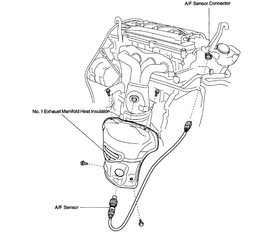

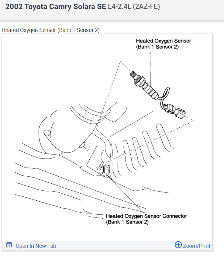

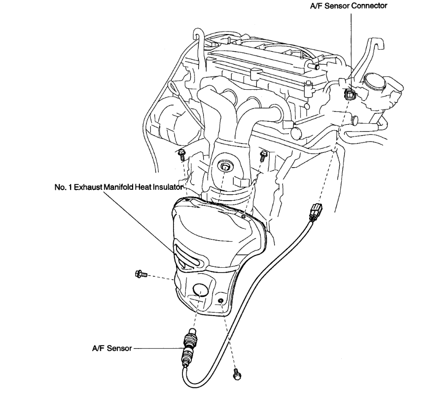

Where is the bank 1 sensor 2 o2 location? I want to replace.
May 29, 2017 at 11:37 AM
The bank 1 sensor 2 is the oxygen sensor just behind the catalytic converter. Here is a guide to help you step by step and the oxygen sensor locations in the images below.

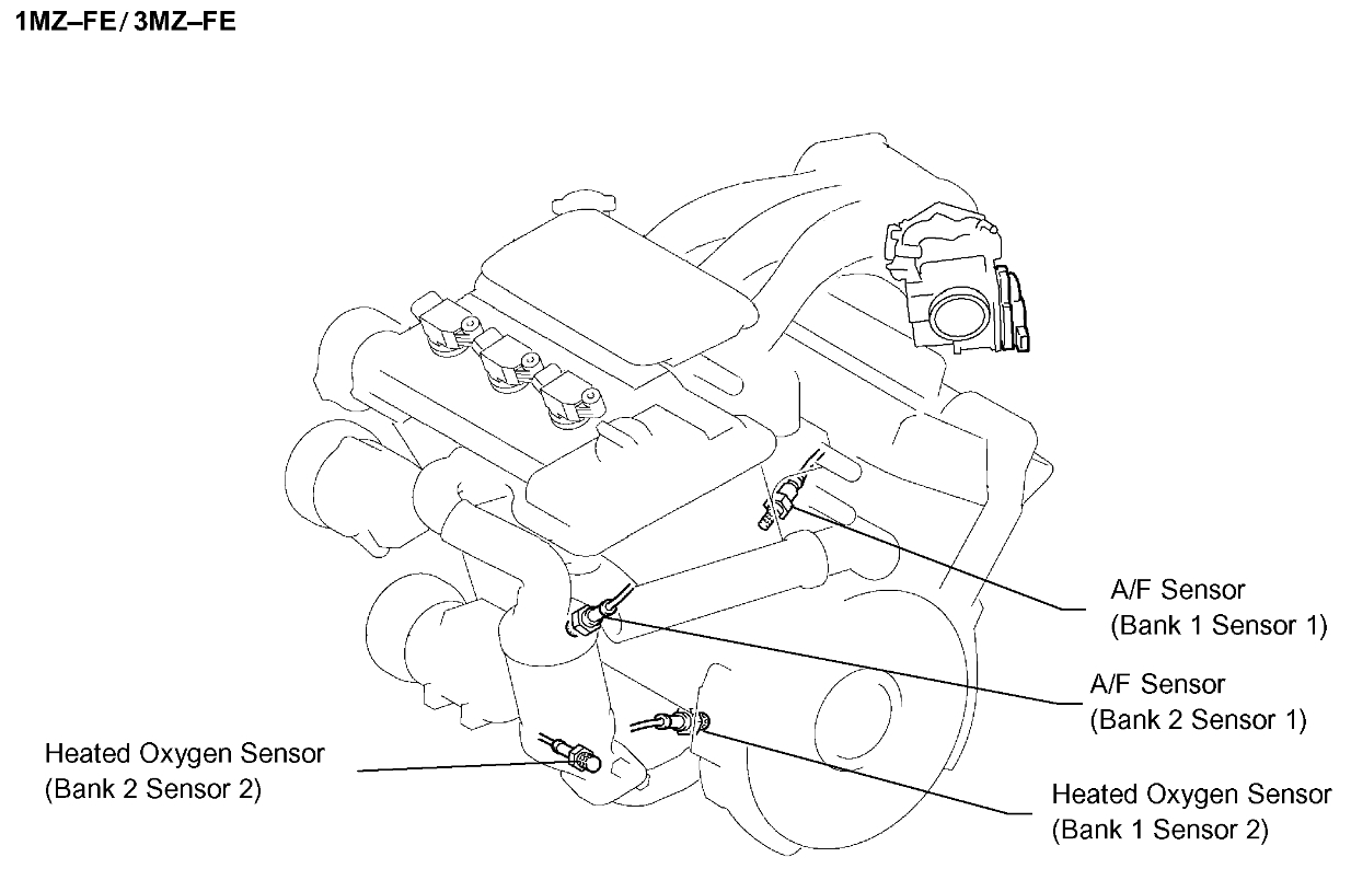

Some Toyotas have 6 cylinders... That means there are two O2 sensors under the car.
Aug 29, 2024 at 12:04 PM
Correct, here are the sensor locations for the v6 engine, they are not quite under the car. Check out the images (below).
