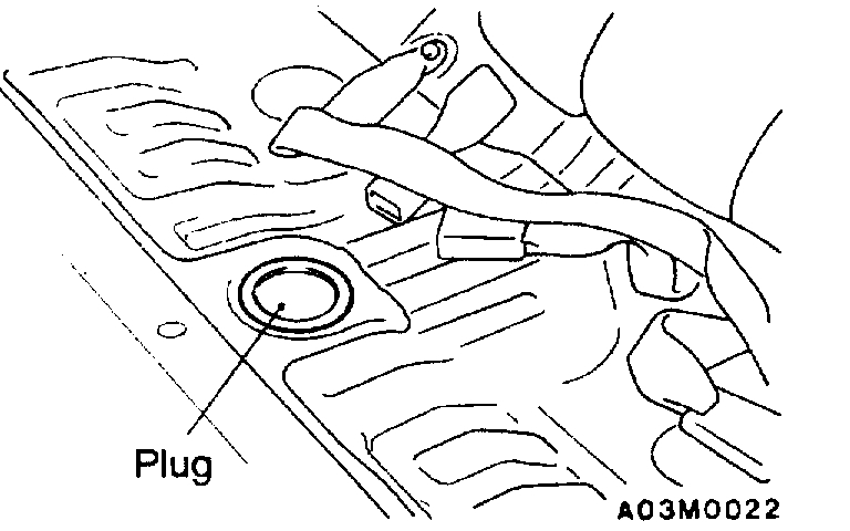

The fuel pump is in the fuel tank. I believe the tank requires removal. However, under the rear seat, there is a large plug that can be removed. I believe it is only for the level sensor, but confirm that. It has been some time since I had one of these in my shop for repair.

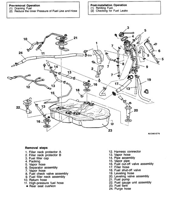

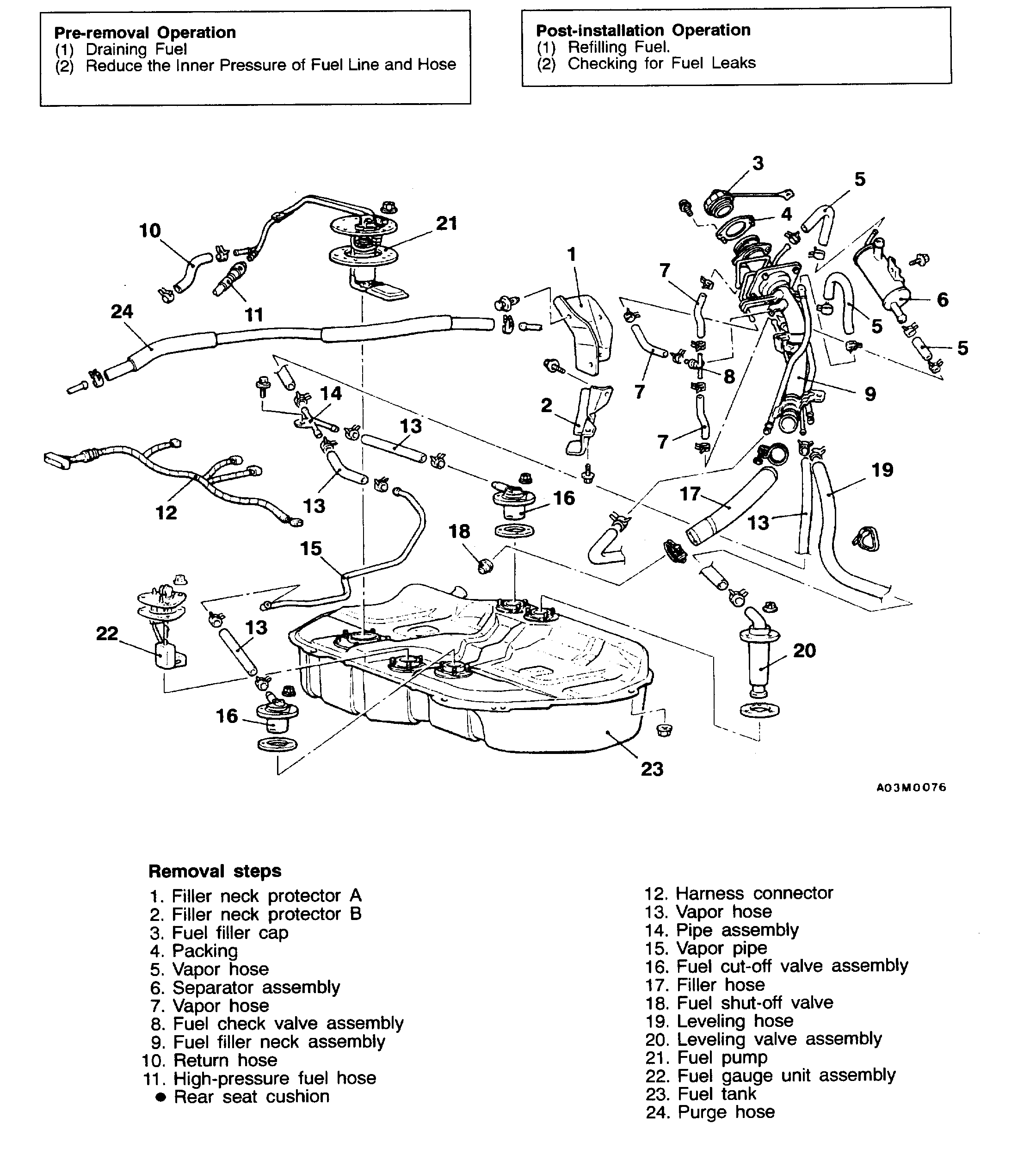

I have attached a picture of under the rear seat, where the plug is located. Also, I attached an exploded view of the tank and its components. It should help if the tank needs removed and as I mentioned, I feel confident it does.
