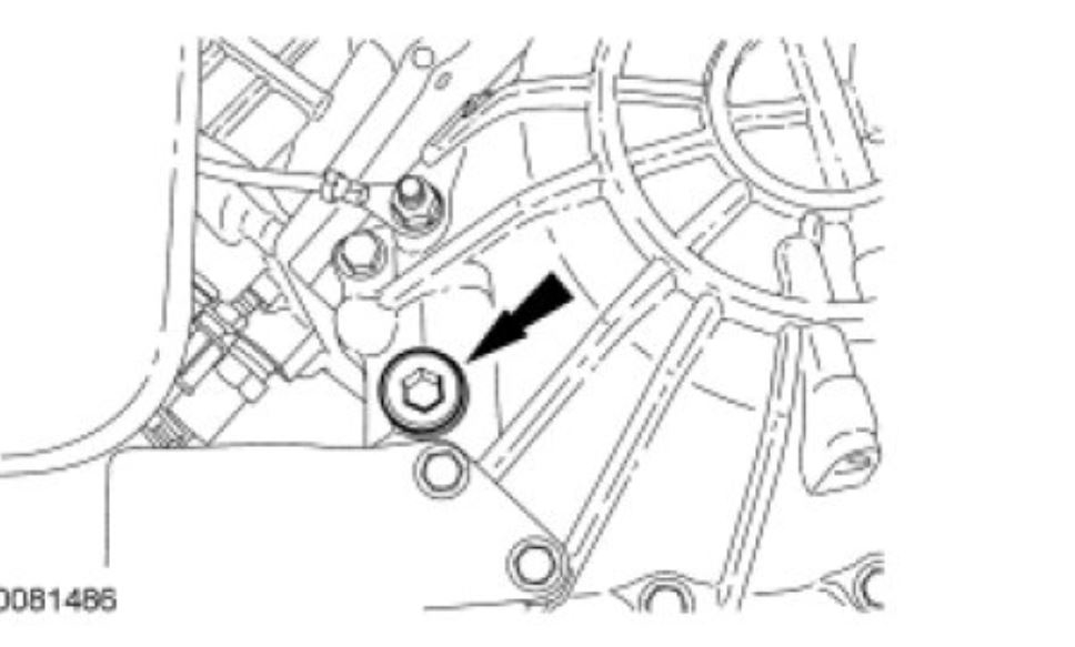

The procedure is below. I attached a picture of the fill plug for you.
I use the one quart bottles and put a hose on the end of the bottle and squeeze the fluid into the transmission. Add until it starts to come out of the transmission.

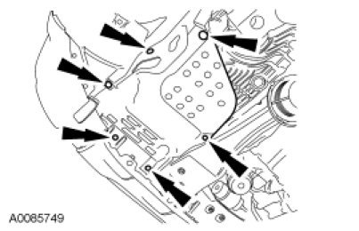

3. Remove the splash shield retainers and remove the left hand splash shield.
imageZoom/Print

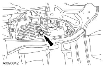

4. Note: If an integral problem is suspected, drain the transmission fluid through a paper filter. A small amount of metal or friction particles may be found from normal wear. However, if excessive metal and friction particles are present, internal service will be required.
Remove the drain plug and drain the transmission fluid.
imageZoom/Print

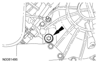

5. Remove the fill plug on the side of the transaxle.
imageZoom/Print
6. Note: After the transmission fluid has been drained, clean the drain plug threads and apply a small amount of thread sealant to the threads.
Install the drain plug.
- Tighten to 40 Nm (30 lb-ft).

Fill the transaxle with clean transmission fluid as specified until the level reaches the bottom of the fill plug hole.
8. Note: Clean the area around the fill plug removing transmission fluid that may have spilled on the transaxle case.
Install the fill plug.
