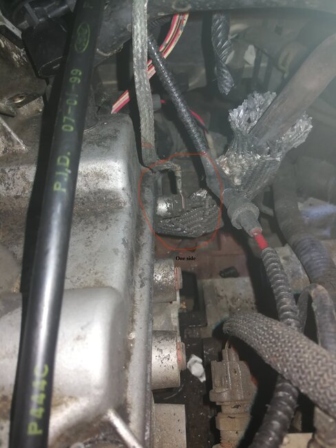

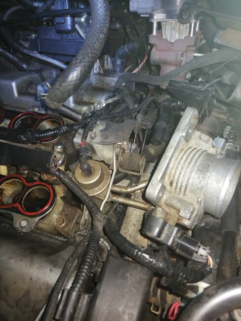

I replaced the two valve cover gaskets. When I put everything back there is a short (about 5in) ground wire I do not remember where to put on. One end of the wire is connected to the lower driver side of the engine. I do not know where to connect to the other side. Since both sides of the wire is ring terminals so I think the other end must be mounted somewhere with a screw or put on a stud with a nut. But I checked the nearby parts like the solenoid and EGR and cannot find any place to put it on. Please help. Thank you.

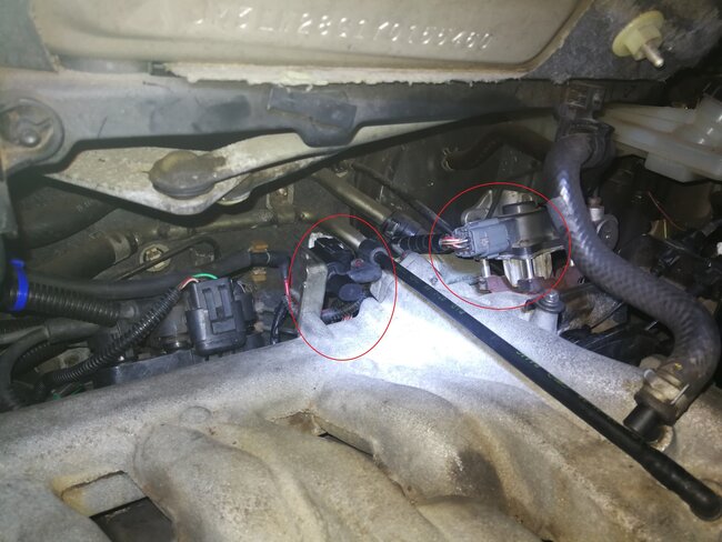

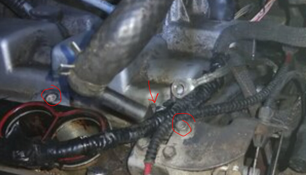

Hi, Joe, thank you so much for your response. The wire is only about 5-6 in long. It cannot reach anywhere like the firewall. Please see my first picture above. It is bolted on the engine and is located under the EGR. I am attaching another picture here. The only two parts it can reach are circled. But there is no place to bolt it on these two parts. I am just learning to work on a car myself. I followed a YouTube video to replace the gasket. When I put everything back, I noticed this wire but don't know what to do with it so I just leave it there. I tested driving the car. It has stopped leaking, but I keep getting a P1520 code. Cleared it and it came back again and again. I looked up the code. autocodes.com says something like "Faulty Intake Manifold Runner Control (IMRC) actuator". But I looked at one YouTube video "DTC Mazda P1520 Short Explanation" (youtube.com/watch?v=kOQ7n5LnNIg) It says "the exhaust solenoid control circuit is shorted to voltage, ground, or open when solenoid activation is commanded ON for 2.5 seconds. The exhaust solenoid supply voltage circuit is shorted to ground or open when activation is commanded ON for 5 seconds." So, looks like the code is related to electric circuit. That's the reason I came back to look at the wire. I also did continuity test using a multimeter to the two circled parts and the front IMRC actuator. They are all good. They are all connected well. I really don't know what to do. Right now, the wire is the only thing I can think of. Maybe I am in the wrong direction.

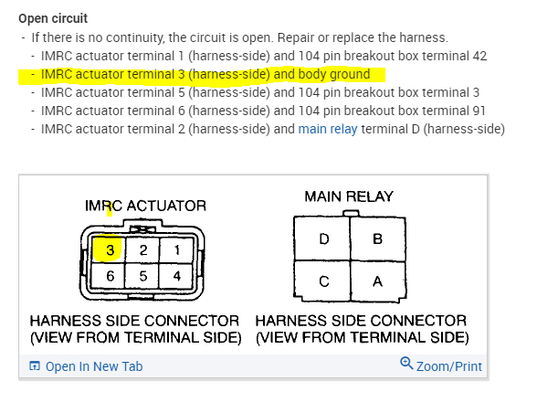

The code is specific to the IMRC circuit. In this case, I suspect an open-to-ground because of that wire.
Take a look at the pic below. I need you to disconnect the IMRC and check pin 3 for continuity to ground. If there is no continuity, then take the unknown wire and touch it to any grounding location to see if that changes the continuity from the IMRC.

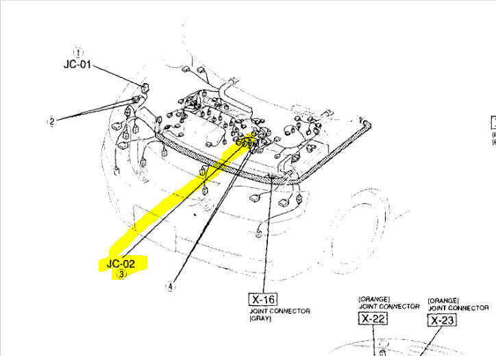

Also, pic 2 below shows junction connector 02 (JC-02) which is where the ground should be for ground G115.
Let me know what you find.

Thank you so much, Joe. I did what you said. I used a multimeter red pin to touch the #3 and black pin to touch battery negative. The meter shows 1 so not good. Then I used another wire to connect the unknown wire to battery negative and tested #3 again. Still showed 1.
As for the 2nd picture, I am not quite sure if I understand it I looked at the marked place on the picture, there is no junction connector there. I took a picture in that place (driver side of the engine).

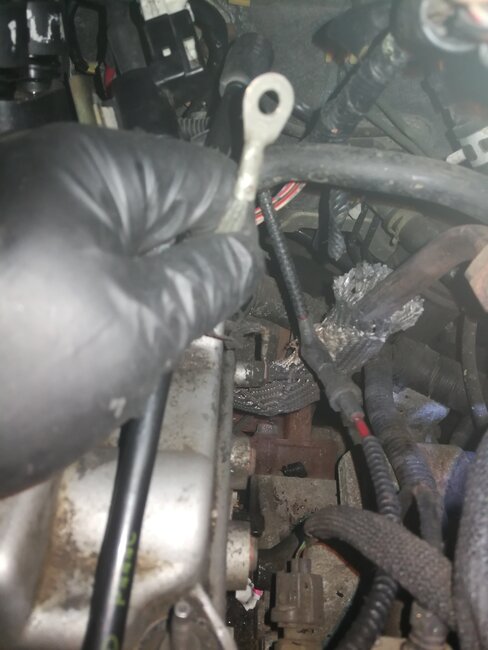

Okay, I copied your pic. I have an arrow pointing to what appears to be a bolt. Is that correct? It's hard to tell in a pic. Also, are there any bolt holes for the intake located near the wire?
If you said no to each question, take the ground you have and simply ground it to a bolt to see if that makes a difference. Additionally, let me know if the ground is long enough to reach the transmission.
See pic below.
Mar 1, 2023 at 6:59 PM

Yes. That is a bolt. I thought about putting the unknown wire on it before because I feel it should go there. But that does not make sense because if so, both ends of the wire will connect to the same piece of valve cover.
I looked around many times in the last few days for the bolt hole but cannot find any.
The unknown wire itself cannot reach transmission because it's only 5-6 inches long. (Unless I join it with another piece of wire like I did above.)

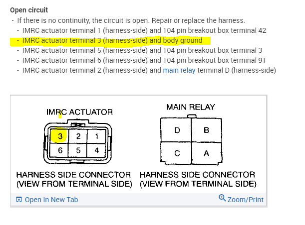

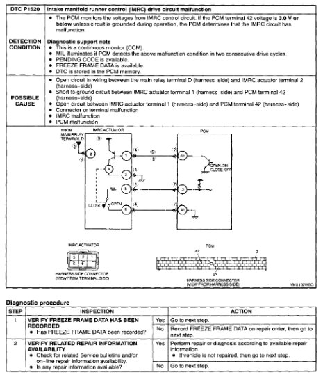

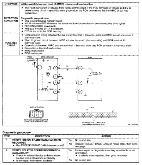

The code, P1520, is what is called a type B code. Basically, the MIL turns on after two consecutive failed driving cycles. Chances are that is why it takes two starts for it to set.

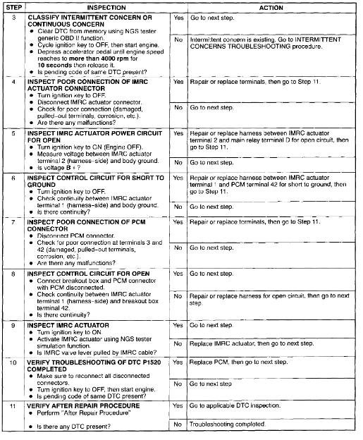

I attached the diagnostics below for the aforementioned code. Take a look through them and let me know if you are comfortable performing them.
See pics below.

Hi Joe, thank you for the detailed instructions. I believe I can do it. Actually, I have to do it. The situation is I will have a safety inspection in June, and I will not be able to pass it with the engine light on. The car's value is only about $1,000 It's not worth it to go to dealers / shops. It happened to me many years ago with an old Honda that was worth about $800 At that point of time, I had no idea about fixing cars and I had to post at craigslist and explain everything. A handyman came to take it for $300.00 I started to learn working on car a few months ago by watching YouTube. I replaced several cars' brake pads and drums and replaced one Honda Civic's timing belt and crankshaft / camshaft seals. So now I have some experiences. It's the first time I am working on electricity. I want to gain some experience in this area.
I followed the instructions. I also ordered some tools like the breakout box that have not arrived yet.
At step 5, there is a voltage. The solution is to replace the harness between terminal 2 and the main relay terminal D. I am going to work on it. I think instead of replacing the harness, I will cut the plastic tube and tape around the harness and visually check every inch of the wires inside to see if I can find the broken section and then fix it if possible.
At step 6, there is no continuity right now.
Thank you very much. Will let you know.

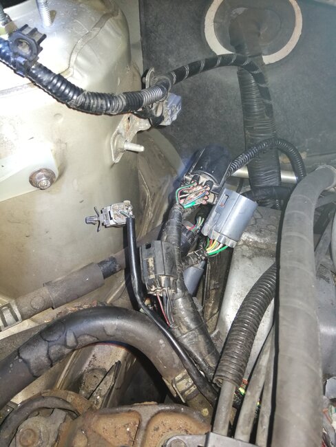

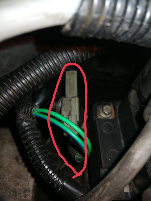

Hi Joe, I did it! I did two things. Most possibly the 2nd fixed the issue. I checked the wires and couldn't find any problem this afternoon. I had no idea and just thought about anything I could do. First, I opened the four big connectors and spray electronic cleaner on both sides (picture 1). Second, I looked at a part (Picture 2). I do not know what it is. It has a 2x0.5in metal plate at the bottom. There is a screw hole at the end. What I did was I used a bolt to mount it to the top of the plastic coil pack. Suddenly I realized maybe the metal plate is this part's ground. I should put it to the bottom of the coil pack so that it can touch the valve cover (Remember, the unknown ground wire before. Now this wire connects the valve cover to the engine). After I did those two things and put everything back, the code is gone. Before it always came out the 2nd time I started the engine. Tonight, I have started the engine about eight times, and it has never come out again.
I will test more in the next few days. Hopefully the issue has been resolved. Thank you very much. Without your help and encourage I cannot do this work.
