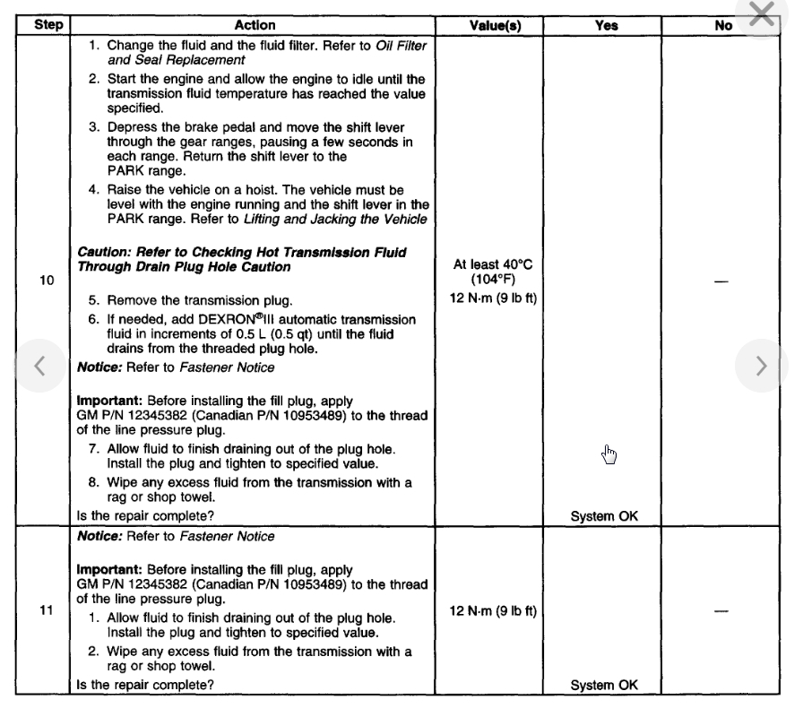

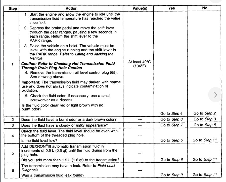

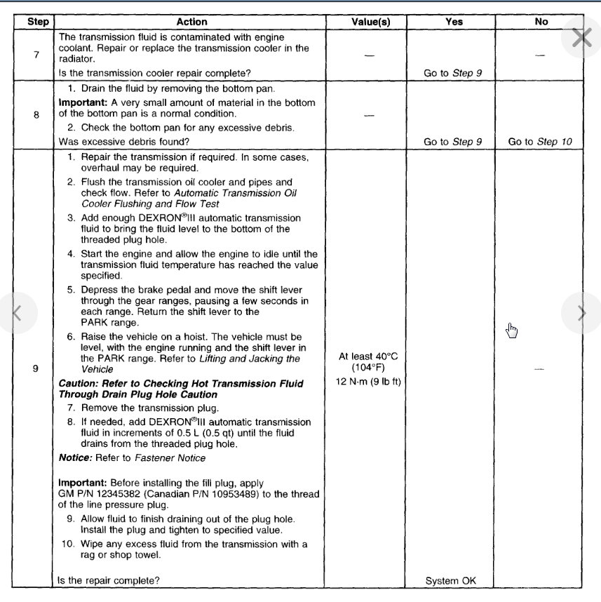

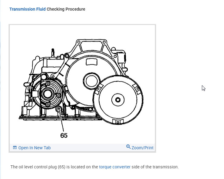

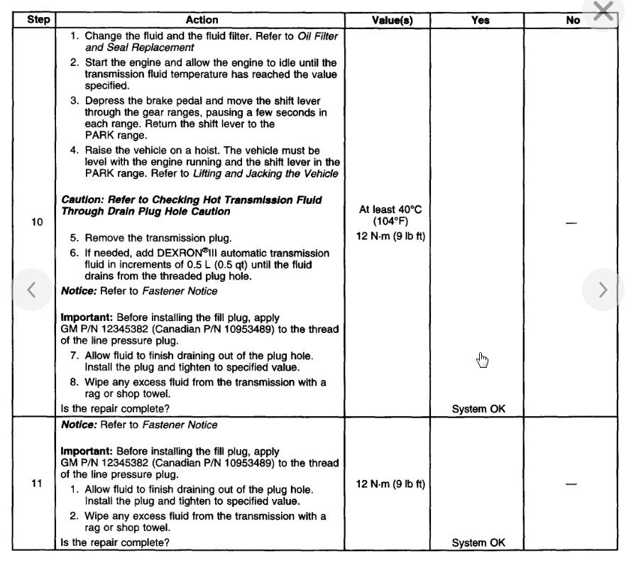

Your vehicle does not have a dipstick. It has an inspection/fill hole. Basically you remove the plug and the fluid needs to be even with the bottom of the hole.
Here is the complete procedure.
