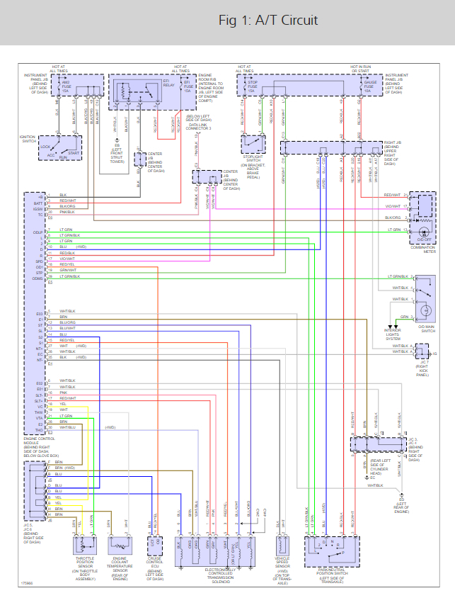

I cannot find any diagrams on the sensor location which is strange but I did find the wiring diagrams which show the color wires going to it and the description of where it is. On top of the tans axle.
