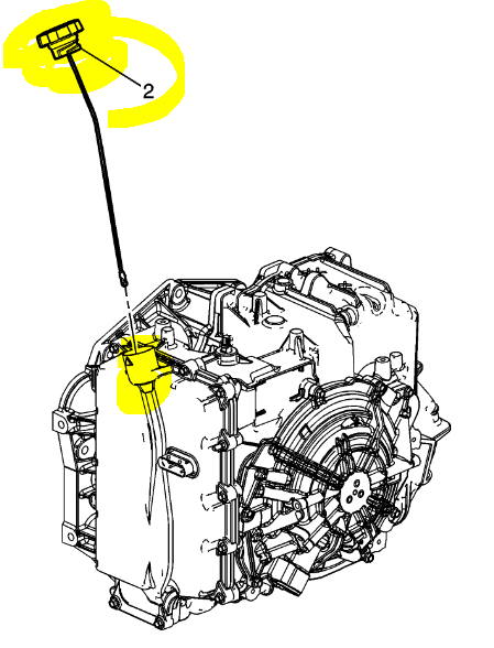

No problem whatsoever. It isn't easy to see. Heck, if this was a Pontiac Torrent, you would need to remove one of the engine mounts to check it. LOL

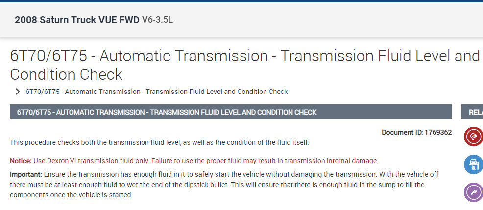

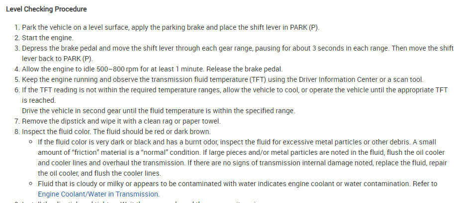

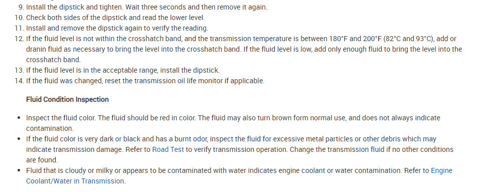

As far as checking, I attached the directions below which also include inspecting the fluid condition. Take a look through them and let me know if you have questions.

See pics below.
