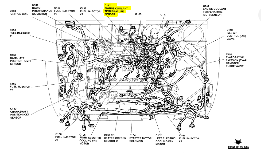

Where is the temperature sensor gauge located on my engine
1995 FORD WINDSTAR
268,000 MILES • 3.8L • V6 • 2WD • AUTOMATIC
BAMBAM519
My temperature gauge will go almost all the way up then go right back down to cold then back up then down again. Then it will go back to normal.
Nov 3, 2019 at 5:41 AM
SCGRANTURISMO
  • 4,897 POSTS
I have included the information that you requested in the diagrams down below. I have highlighted it for you. Please get back to us with how everything turns out. I hope this helps.
