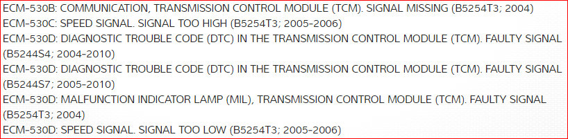

My Volvo is limp mode and stuck in the third or fouth gear. It also has CEL on and displays 'Transmission Service Required'. I pulled these codes ECM 530D DTC, TCM 0048, TCM 0192. I read in another forum that cleaning TCM and ECM contacts can resolve the issue.
Are you familiar with these codes? What do you think is the best way to resolve the issue?

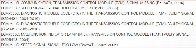

Here is what I found regarding your transmission codes. You can start with trying to clean the connections but, not sure it would help. You can always try and hope for the best right? The ECM 0530 and TCM 0048 I attached a picture of and the only close TCM 0192 that I found was TCM 0092 and it was transmission related. I attached a picture of that as well. Hope this helps!

I cannot see the first two images.

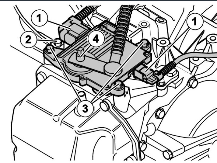

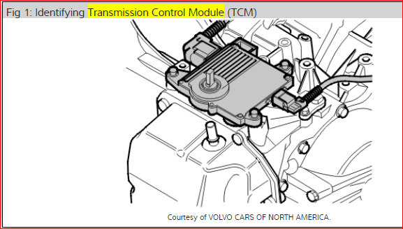

DANNY L
  • 5,648 POSTS
Hello,I'm Danny.
The TCM is located on the top of the transmission.You will have to remove the air cleaner assembly to gain access to the module. I've attached a picture below of what it looks like and location.Let me know if you need replacement instructions as well.Hope this helps and thanks for using 2CarPros.
