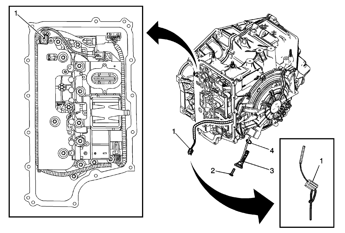

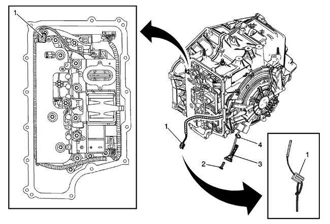

Sort of. On the 6T70 trans-axle the sensor is actually on the outside of the transmission BUT the connector goes through a seal and into the valve body cover to connect inside.

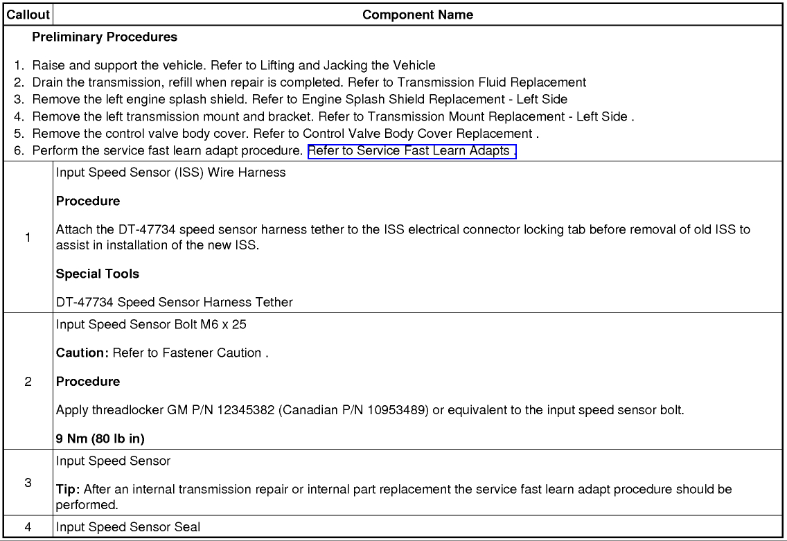

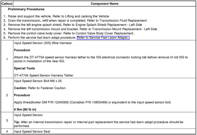

The bigger issue is that you need a scan tool that can talk to the transmission controller and run the adaption protocol after you change the sensor.
