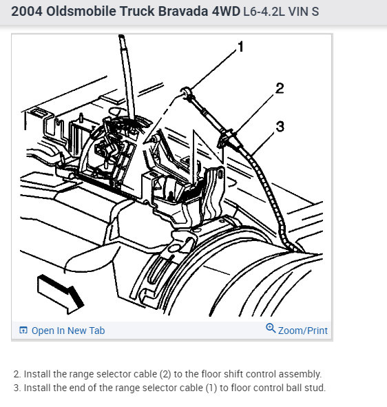

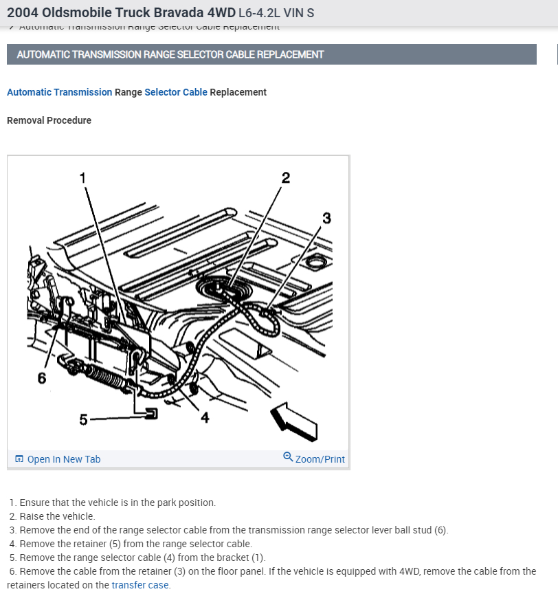

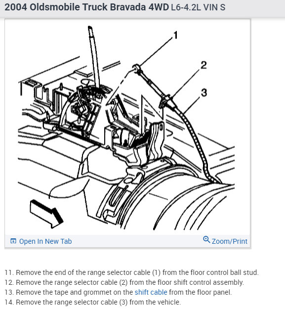

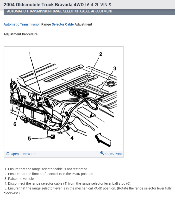

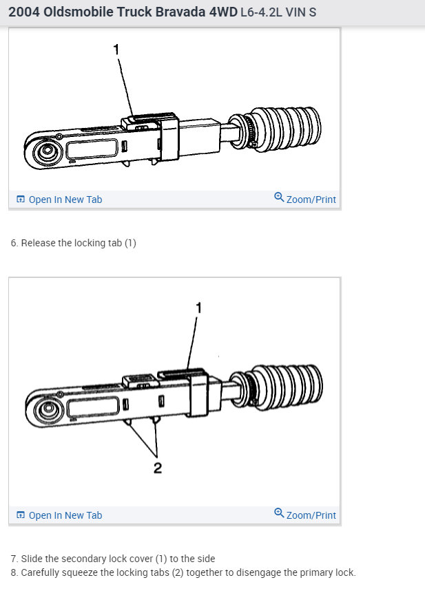

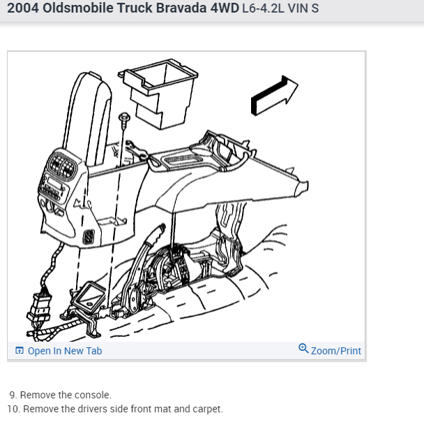

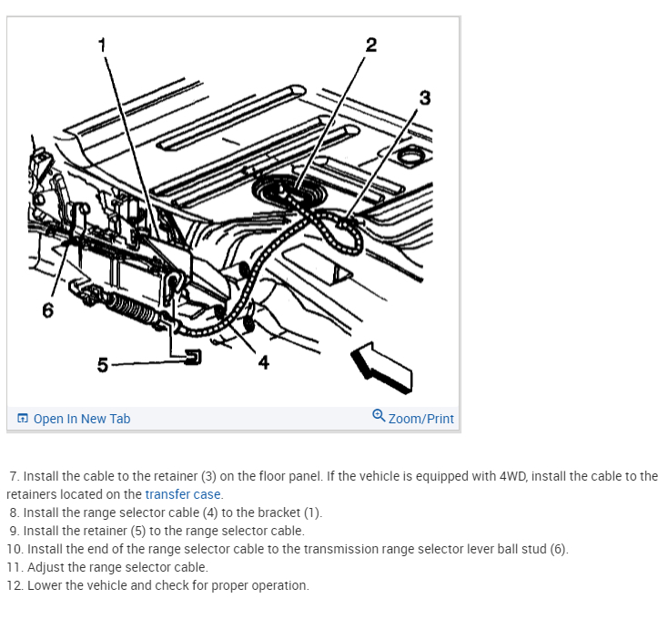

I went to put it in drive and the shift lever moves freely but it's stuck in park. I need to see if the cable came off or if the bushing is shot, but I don't know where to look. Could you help? Thanks.
