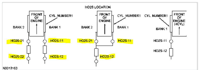

If it is just a sensor, here is a link that explains how to replace one. I attached a pic below showing the locations of the sensors in the exhaust system. The different designs are based on what the exhaust system used.
https://www.2carpros.com/articles/how-to-replace-an-oxygen-sensor
See pic below.
