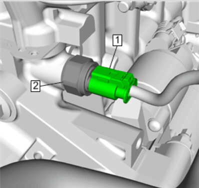

I was the victim of a hit and run accident. My Chevrolet was hit on the passenger side and my car was wedged up on an intersection island. After the accident my oil pressure sensor warning light came up on the dash and hasn’t gone off. I’m trying to find out if the sensor could have been damaged by the bottom of my car scraping across the intersection island?

It should be on the block near the starter. I have attached a diagram for reference.

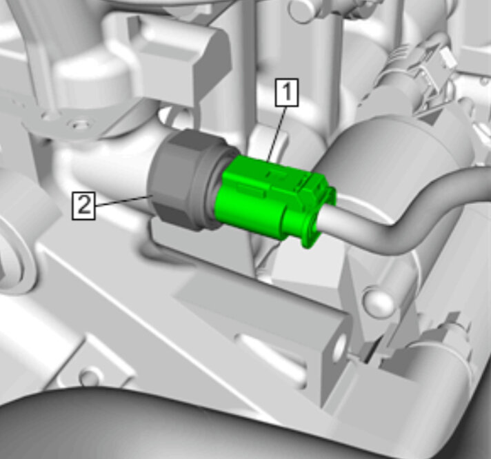

Yes, good call, but I would look at the engine oil pan to make sure it is not dented which will clog the oil pump pick up and make the light come on. Here is the location of the oil pressure sensor which is right above the starter motor so you can see if it got damaged as well. Please upload a short video in your response of the problem, so I can see what's going on :) Check out the images (below).
