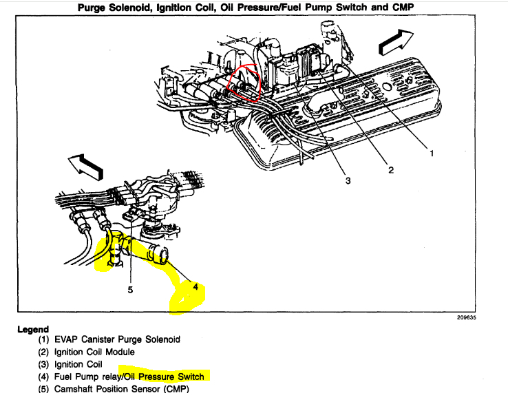

Where is the Oil Pressure Sensor, engine is a 5.7L Vortec 7400.

I've looked up multiple diagrams on the internet and there are far to many. So Lets ask the experts. Where is it?

The oil pressure switch should be right next to where the distributor is located on the rear of the engine.
I attached a pic below. I highlighted the sensor on one section and circled where I believe you will find it.
Let me know if this helps.
See pic below.
