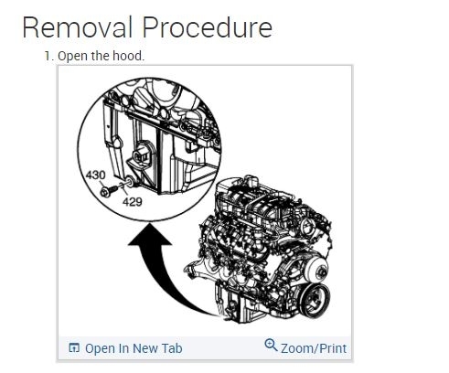

Do not know where the drain plug is for the oil release.
Feb 18, 2018 at 12:38 PM

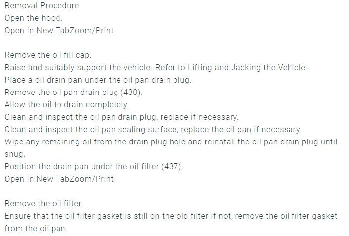

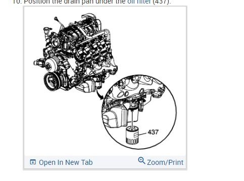

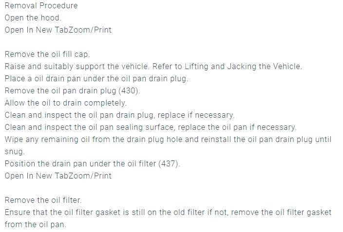

The oil drain plug for the engine oil is on the bottom of the oil pan facing the rear of the engine. It is a 15mm headed bolt. I attached a guide for changing the oil and filter and I attached some pictures of the location of the drain plug and the filter.
