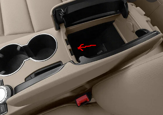

The SD card should be located inside the center armrest/storage bin. If you open it and look towards the inside front, you should see the SD card slot.
See attached picture for reference.
Let me know if you are able to find it.
Thank you.

No, there is not one. There's all plastic, one piece.

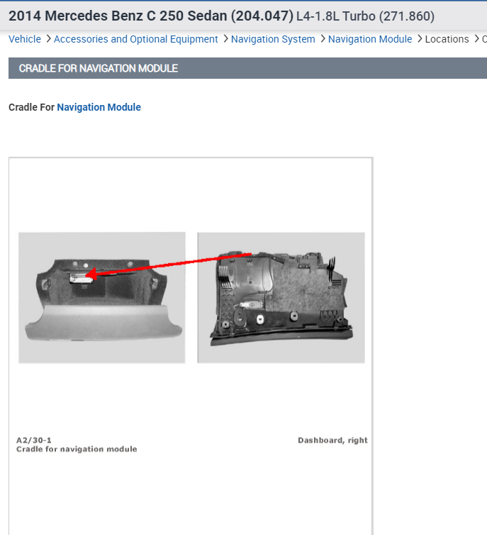

Some of the US models had the navigation module in the upper part of the glove box and they had a spot for the SD card on the module.

Yes, i see this one. Se card on top of the module would mean it has to be removed cUse its mounted. The clickable removable part has the small battery in it. I unclicked and clicked it back fee times, it would start with the name of the device then goes to the error.

It is possible that the module is bad. The only way to know would be to run a diagnostic using specialty scan tool. Which can communicate with all the electronic modules and test working orders.
