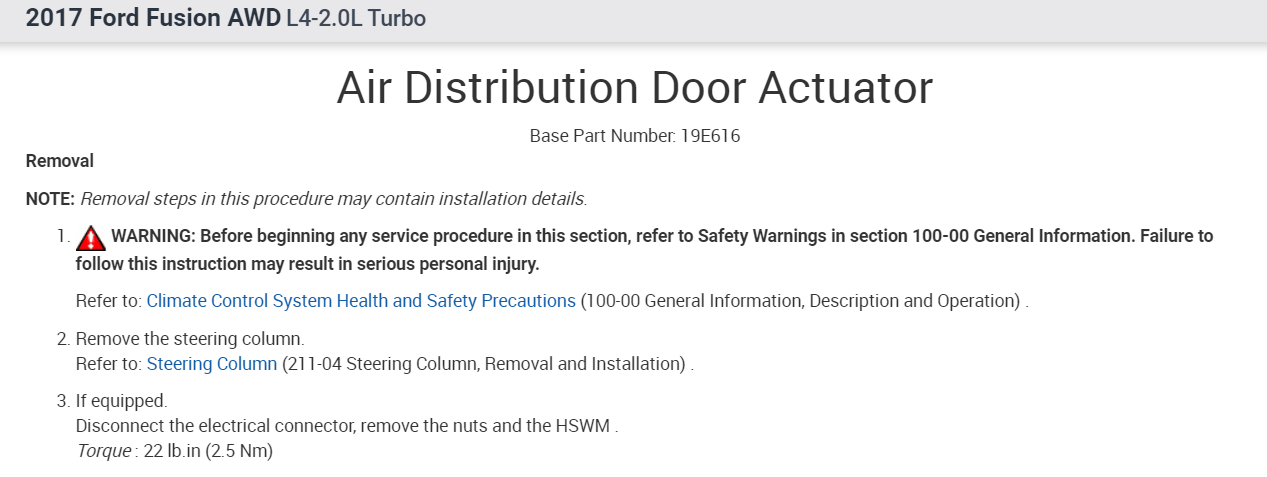

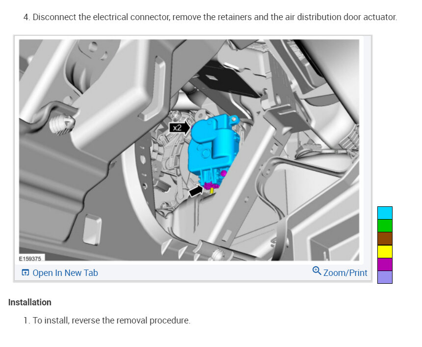

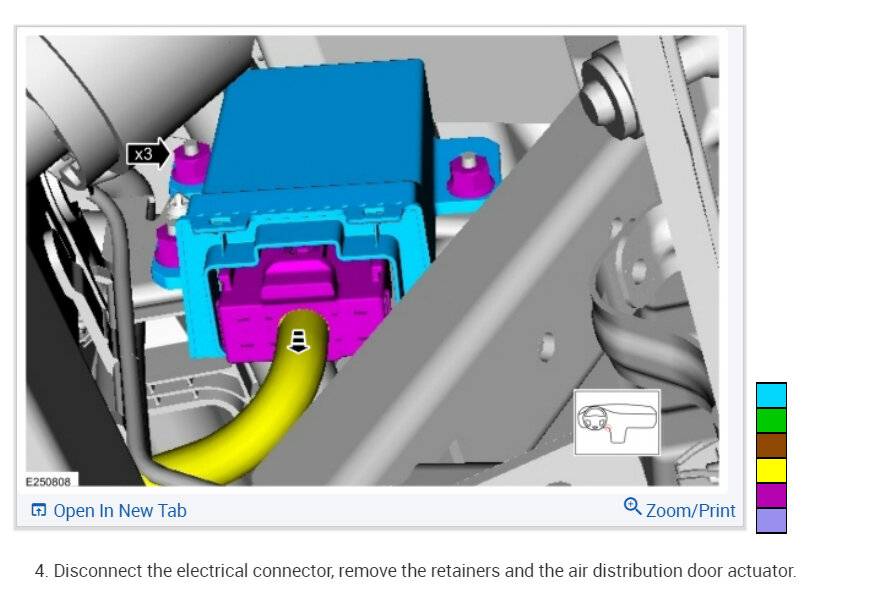

They call it an air distribution actuator and it is under the dash on the passenger's side, here are the instructions on how to replace it in the diagrams below. Check out the images (below). Please let us know what happens.
