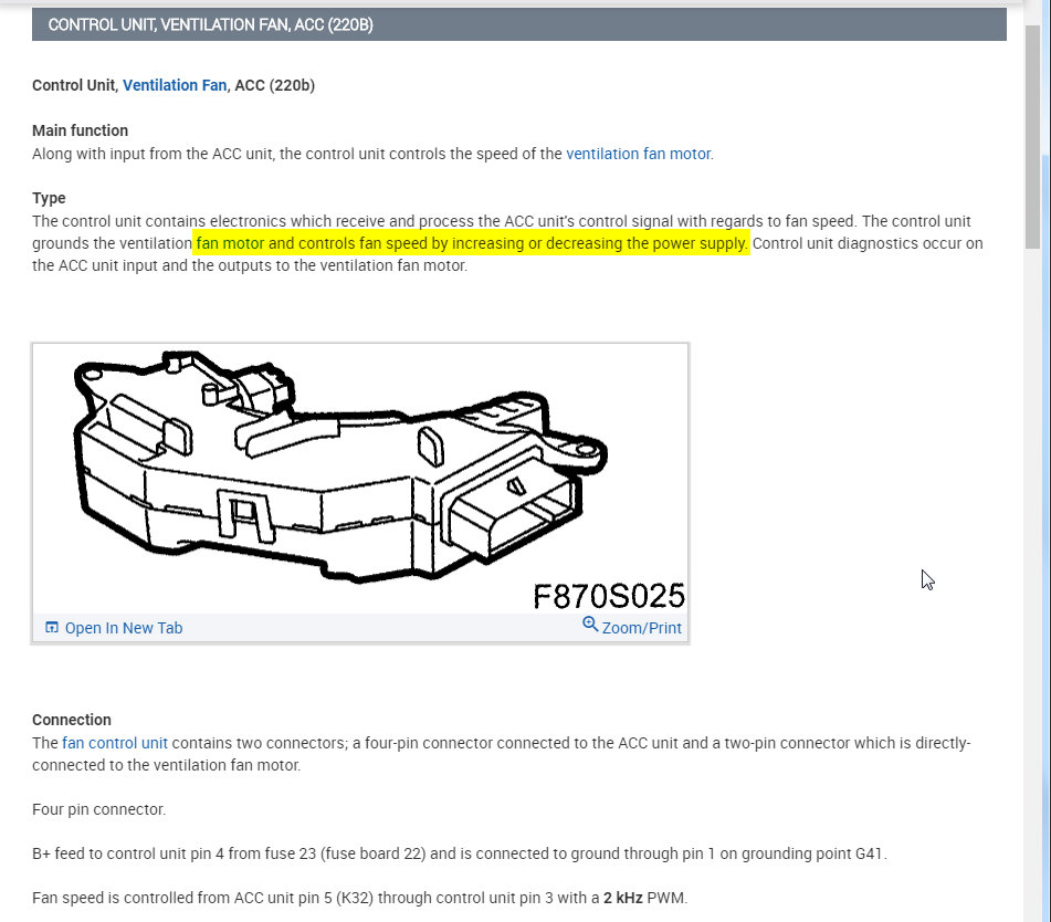

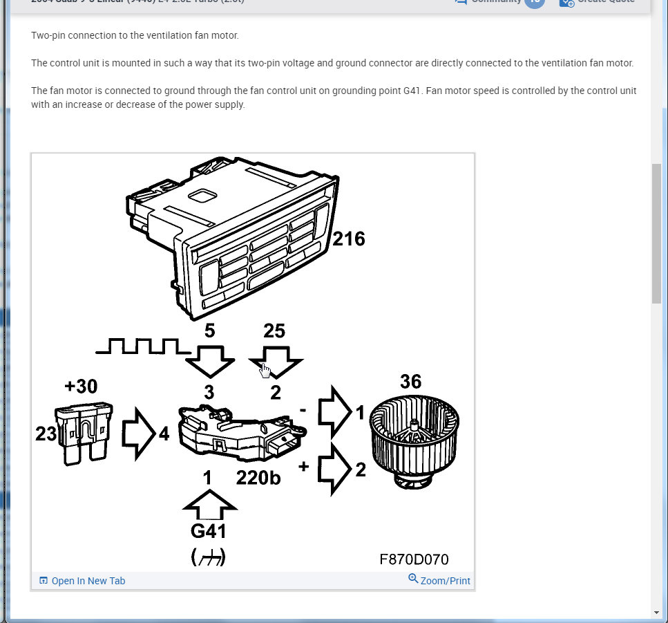

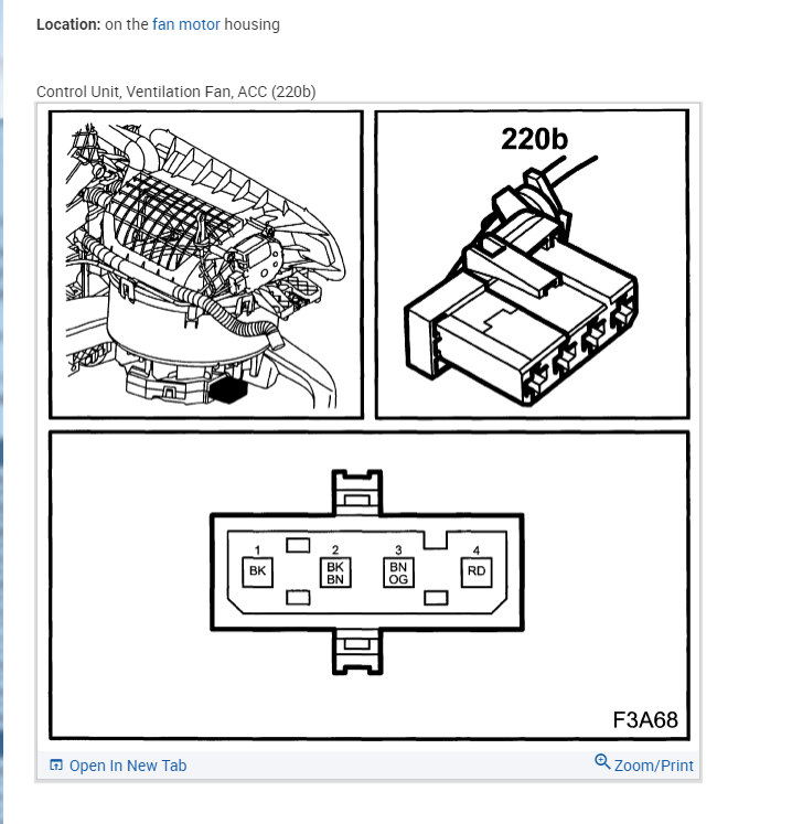

You don't have a traditional resistor. You have a fan control module. I attached the info on this but it is still attached in the traditional location of a resistor which is at the base of the fan motor.
Let us know if you need more info. Thanks
