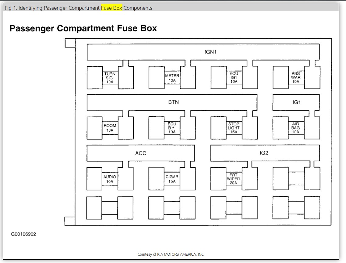

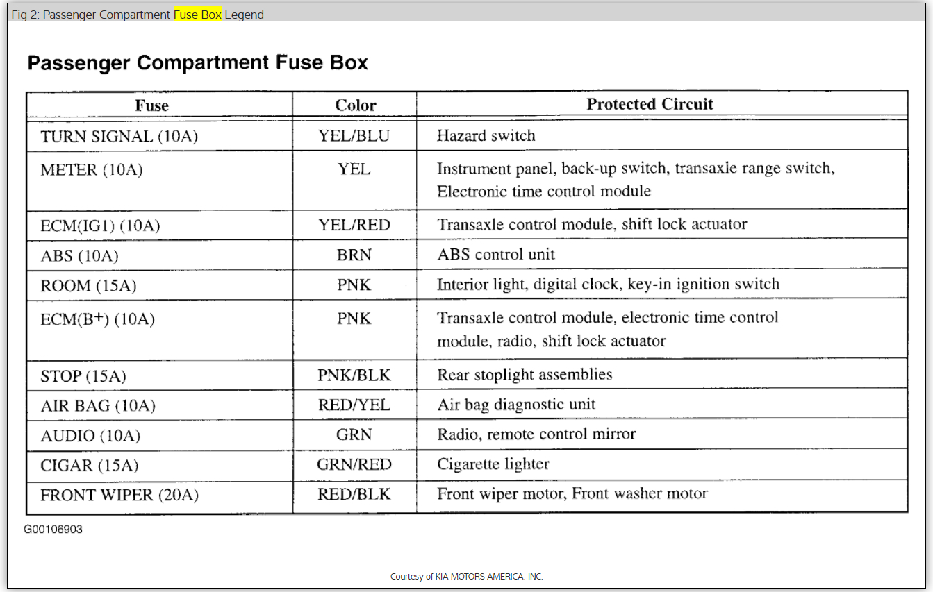

I have no power to the twelve volt accessory access (in retro terms, the lighter) I imagine the fuse for it is in the kick panel. My problem is that the cover which identifies the circuits is gone. Other than having to be much younger to see the fuses and a contortionist I just need to know which it is. Help please!
Jul 29, 2017 at 8:05 PM

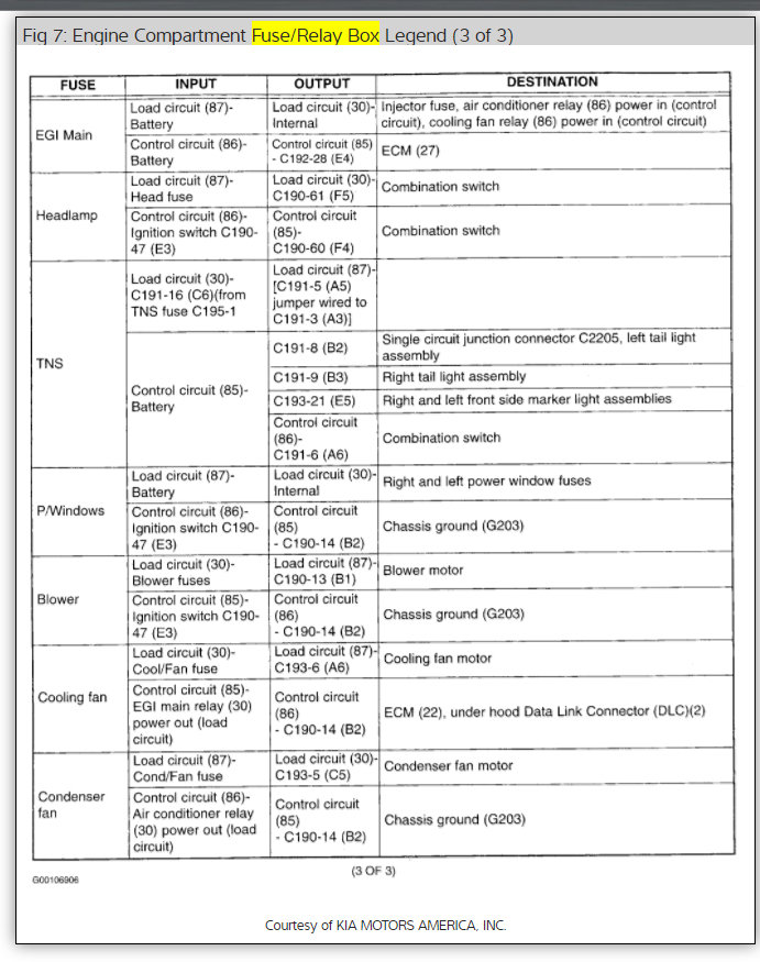

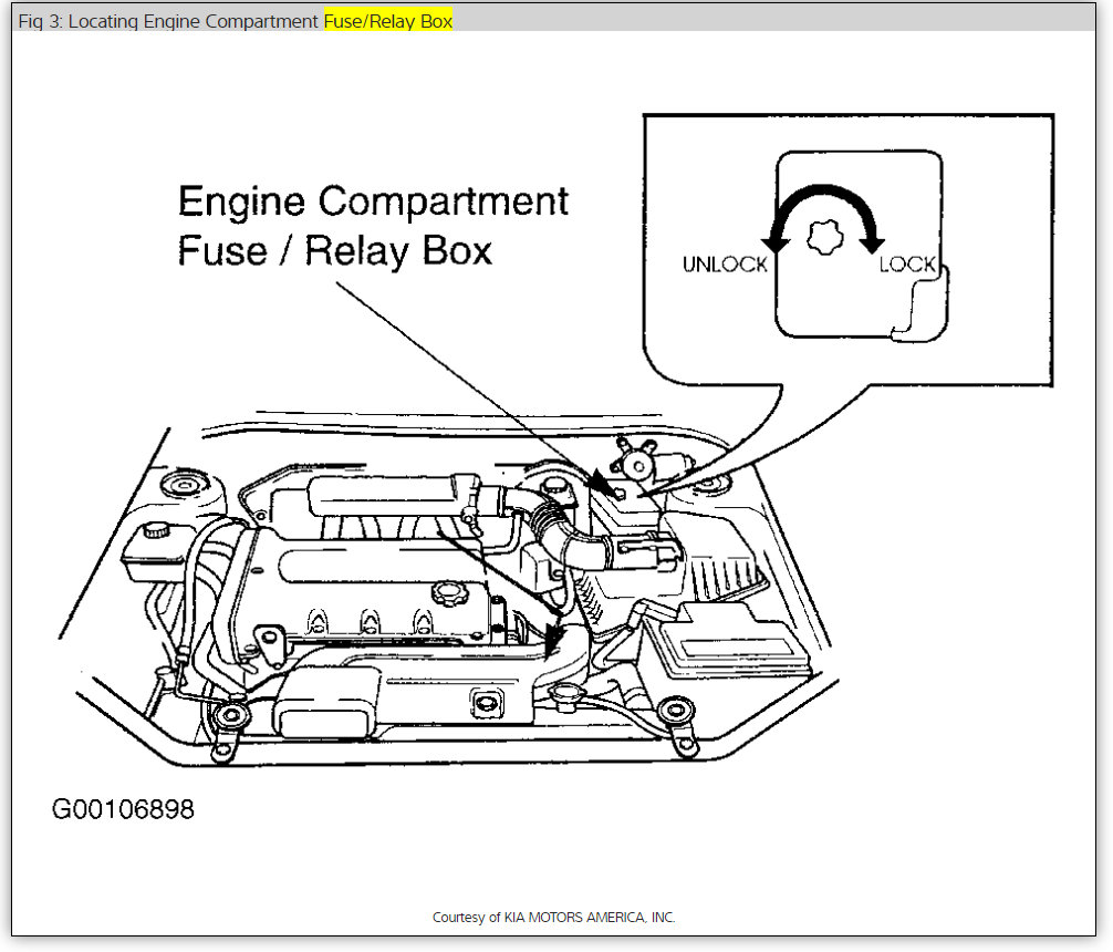

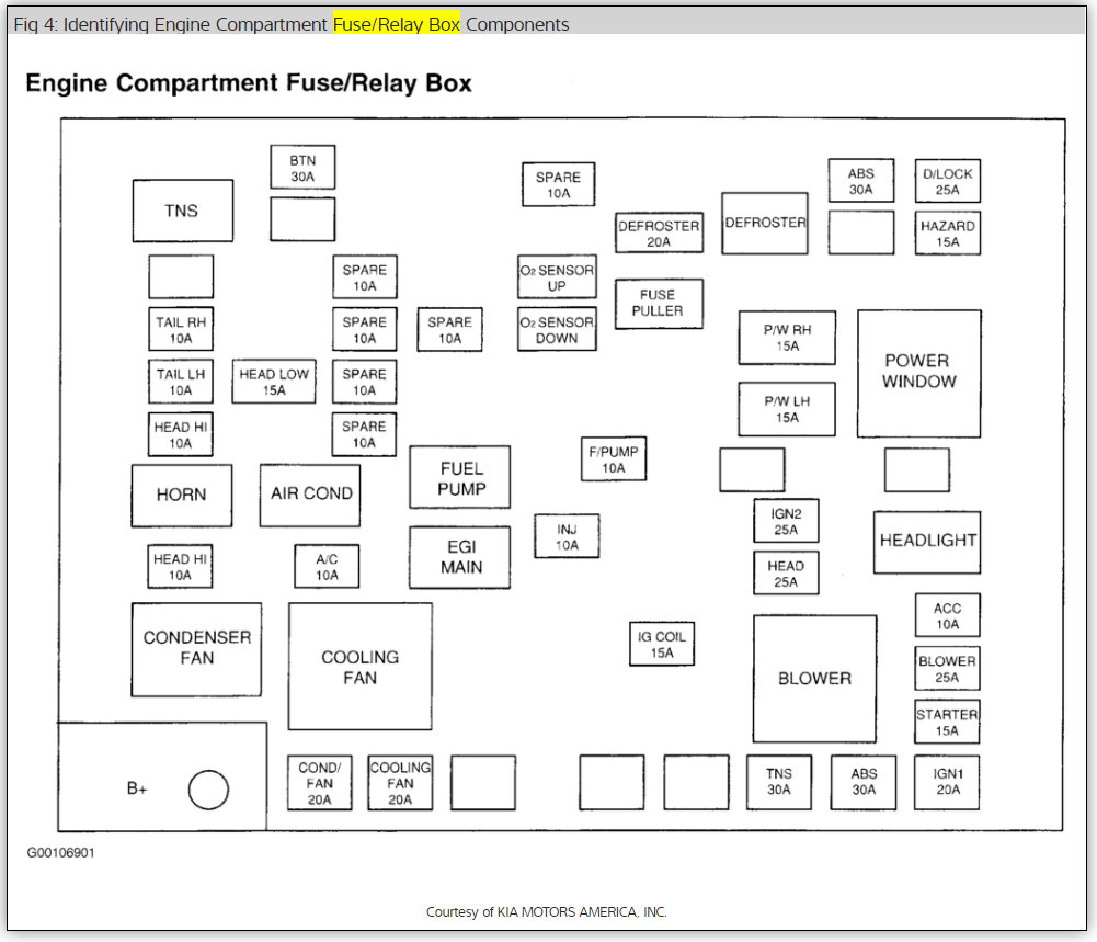

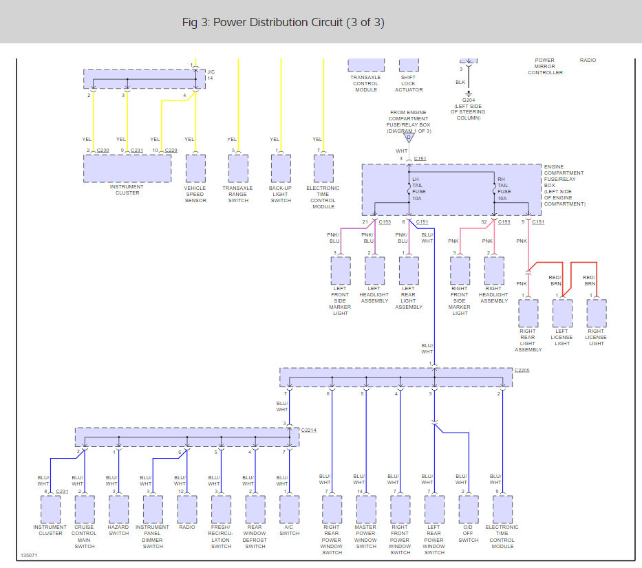

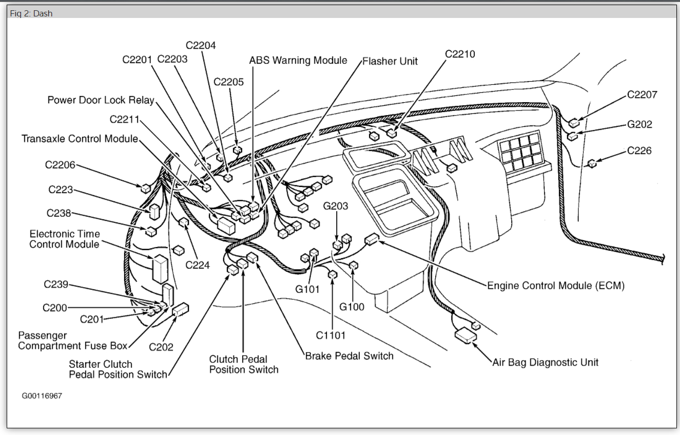

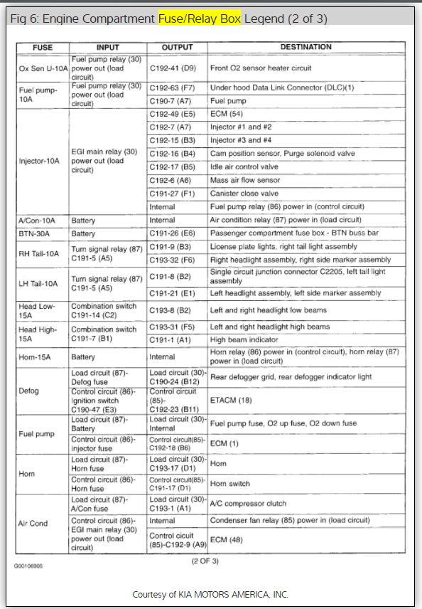

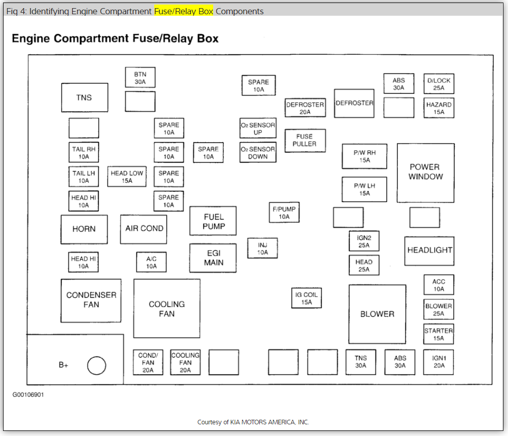

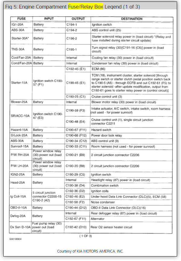

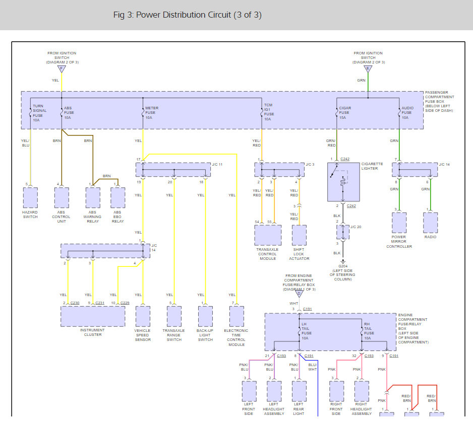

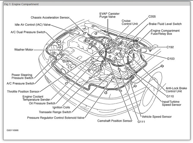

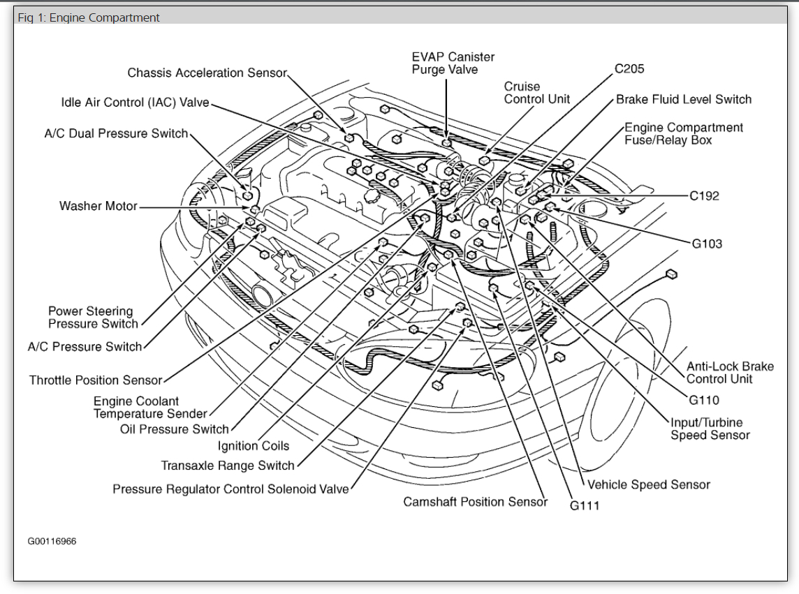

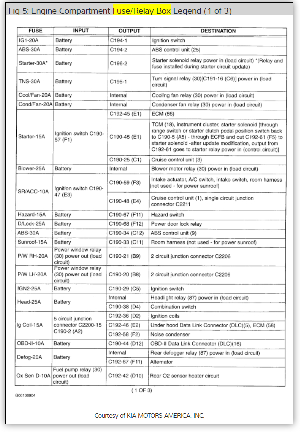

Yes it is the cigar fuse 15 amp in the passengers fuse box on the driver side by the foot well. Here is a guide and some diagrams so you can get the car fixed and on your way.
and
