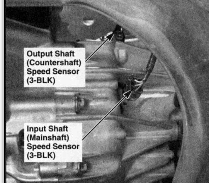

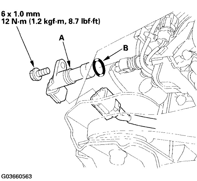

there is a shield that must be removed to access it. see picture.

Where is that located?

  • 48,601 POSTS
under the car by cooling lines in transmission.
