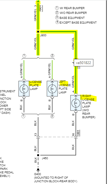

The power to the license plate lights is provided via the body control module and not directly from a fuse.
I attached the schematic showing the lights. With the headlamps or parking lamps on, check the green wire with a yellow tracer for power.
If it does have power, then check the black wire for continuity to ground.
Let me know what you find.
