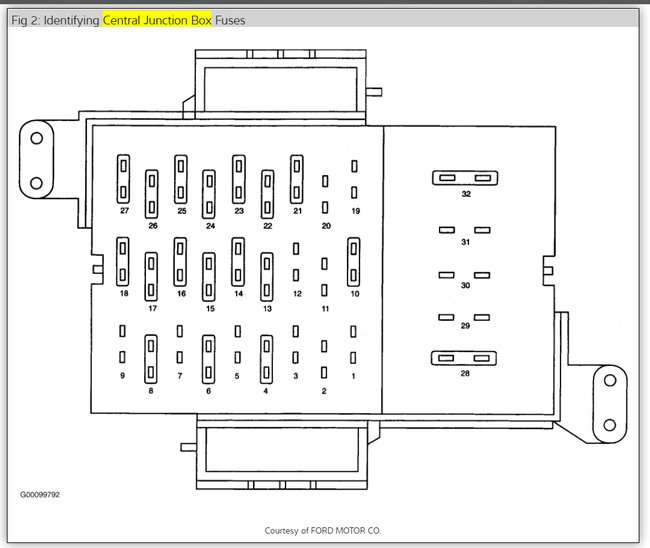

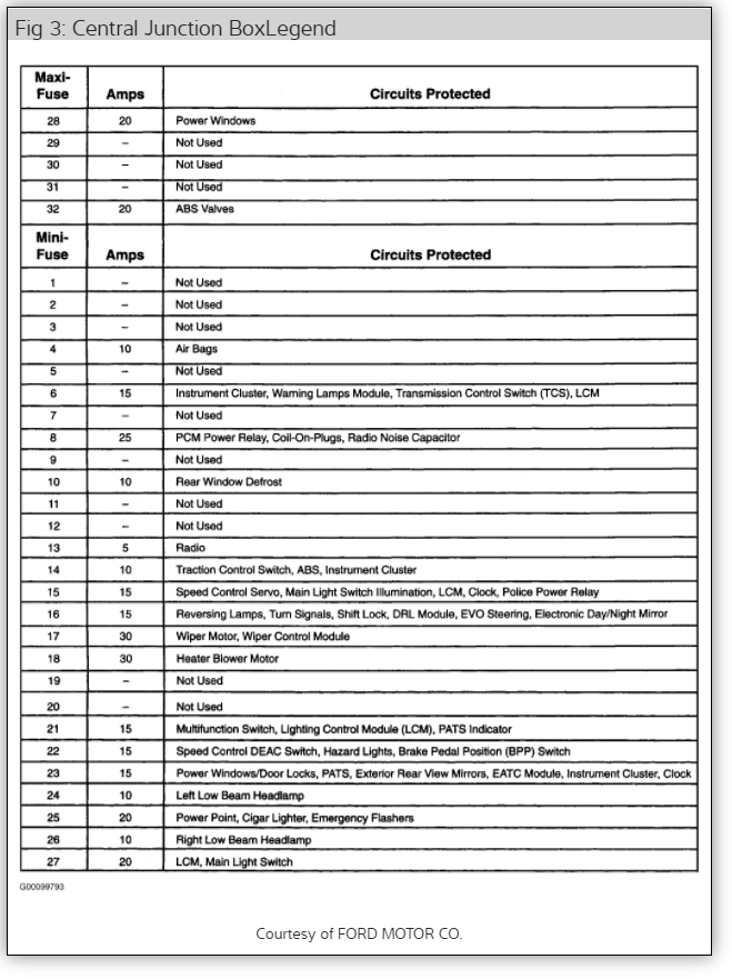

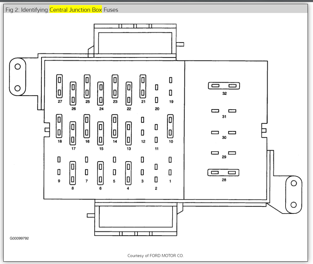

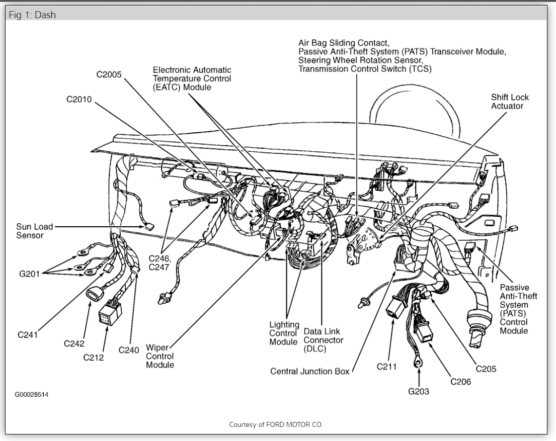

Windshield wipers will not come on..i want to check the fuse but I don't know where it's located?
Feb 12, 2016 at 6:54 AM
HMAC300
  • 48,601 POSTS

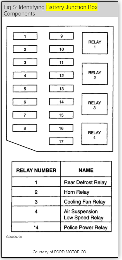

Here is a guide to help you check for power at the fuse and the fuse location and specifications below. Check fuse 2 central junction box.

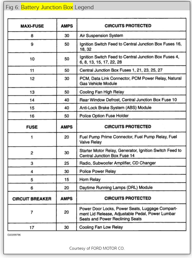

Where is the fuse box located in a 1987 Mercury Grand Marquis? Are there also other fuse boxes located somewhere else in addition to the main fuse panel?
Jan 13, 2019 at 6:31 PM (Merged)
LOSONE
  • 1,616 POSTS
Up under you left knee. There are a buch of fusable links in the engine compartment and some on the starter

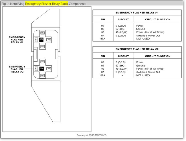

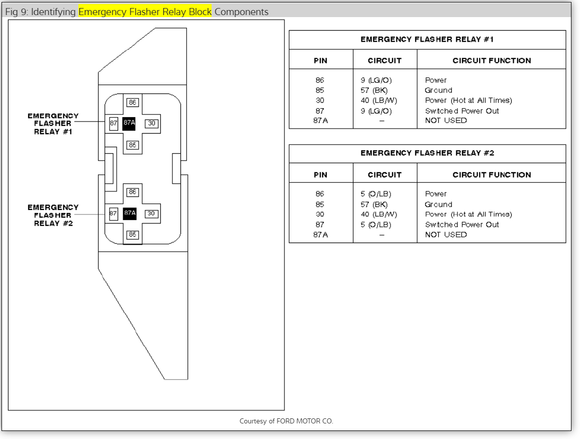

My turn/hazard signals are not working. The fuses are all good. I don't see a flasher in the fuse box under the dash. It stopped working a day ago. What could be the problem? If it is the flasher where is it located? Thank you
HMAC300
  • 48,601 POSTS
see chart also flaser is supposed to be on passenger compt fuse box.

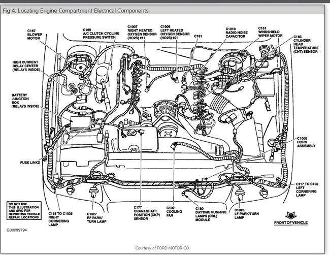

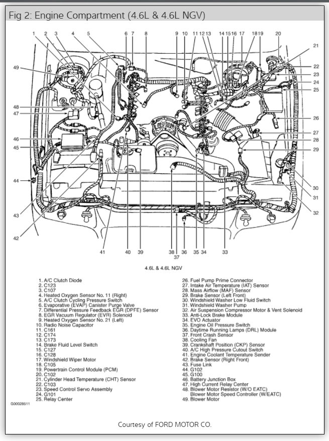

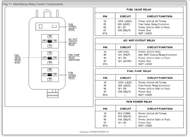

PDUBU

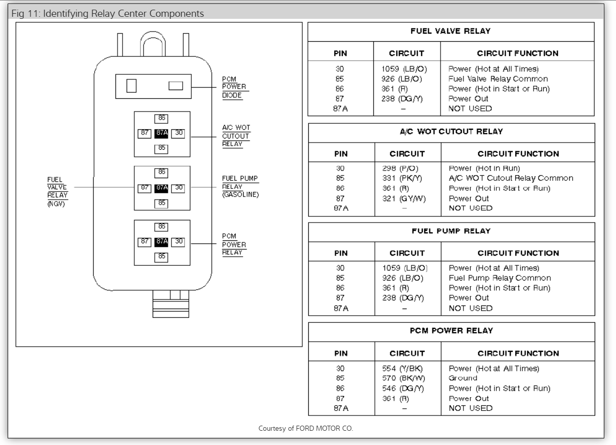

Trying to determine if there is an cause I haven't checked>
Initial Symptoms: Sudden loss of all electricals except interior lights and horn. Wiggled the battery terminals (found to be a bit loose) not change. Waited a few minutes fired up with one more mishap on my way home.
Next day, power available (dash lights), but would ebb away within a 10-15 seconds. Swapped for known good battery,swapped main battery cables for known good ones. Checked every fusible link listed in the owners manual and ever fuse in the fuseblock. Also tested a ECM, Fuel Pump, & A/C relays & diode No luck.
Next check, same ebb of power. Swapped ignition switch. Started and ebbed a few times, then nothing. Swapped switch back to original without change.
I get power to the ignition switch when off, but it disappears when the switched to any on position. I haven't found any broken or damaged wires. Engine will crank if solenoid is jumpered. No power to do a ECU test.
Any ideas?
KHLOW2008
  • 41,814 POSTS
Hi pdubu,
The symptoms described are most probably due to a bad connection. I would suspect one of the main harness connector from the battery to the ignition is bad.
Check for burnt connectors at junction or fuse boxes.
