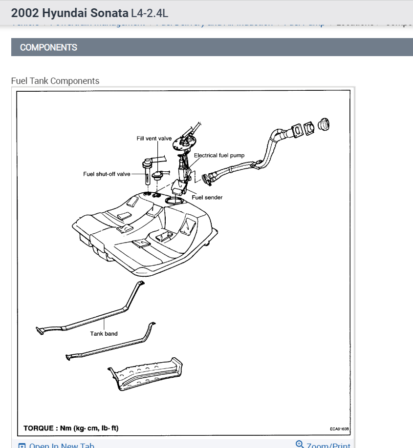

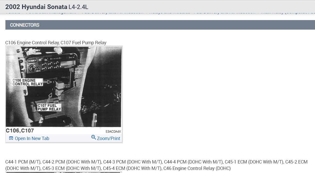

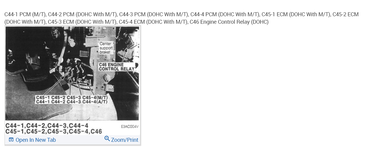

The fuel pump does not have a reset switch like a Ford does. Here is the location of the fuel pump relay, which is the engine control relay under the dash, but I have seen when you run out of gas the fuel pump goes out FYI. Here is how to change out the fuel pump in case you need it:
Check out the images (below). Let us know what happens and please upload pictures or videos of the problem so we can see what's going on.
