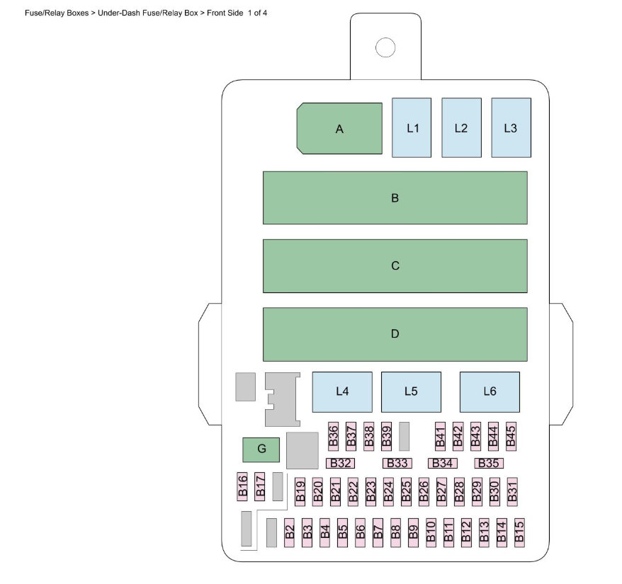

I am looking for the location of the fuel pump relay.

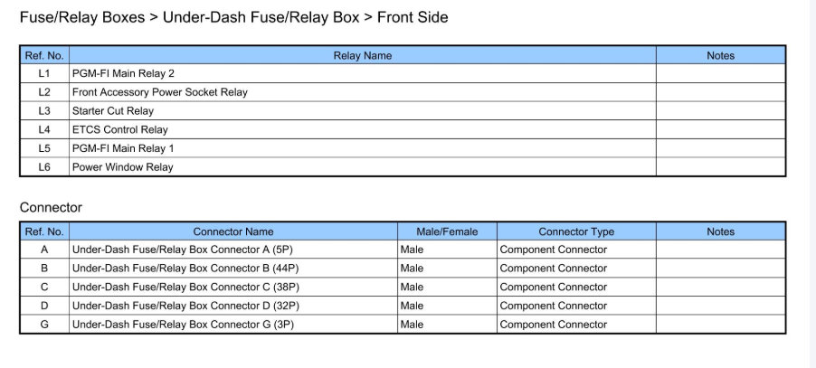

It is located in the under dash fuse/relay box. The fuel pump relay is the PGM FI2 (L1) replay. Here is a guide to help you with the location of the relay below:
Check out the diagrams (below). Please let us know if you need anything else to get the problem fixed.

The numbers 2 and 9 do not exist on the diagram provided.

This post has been updated please check it out (above).
