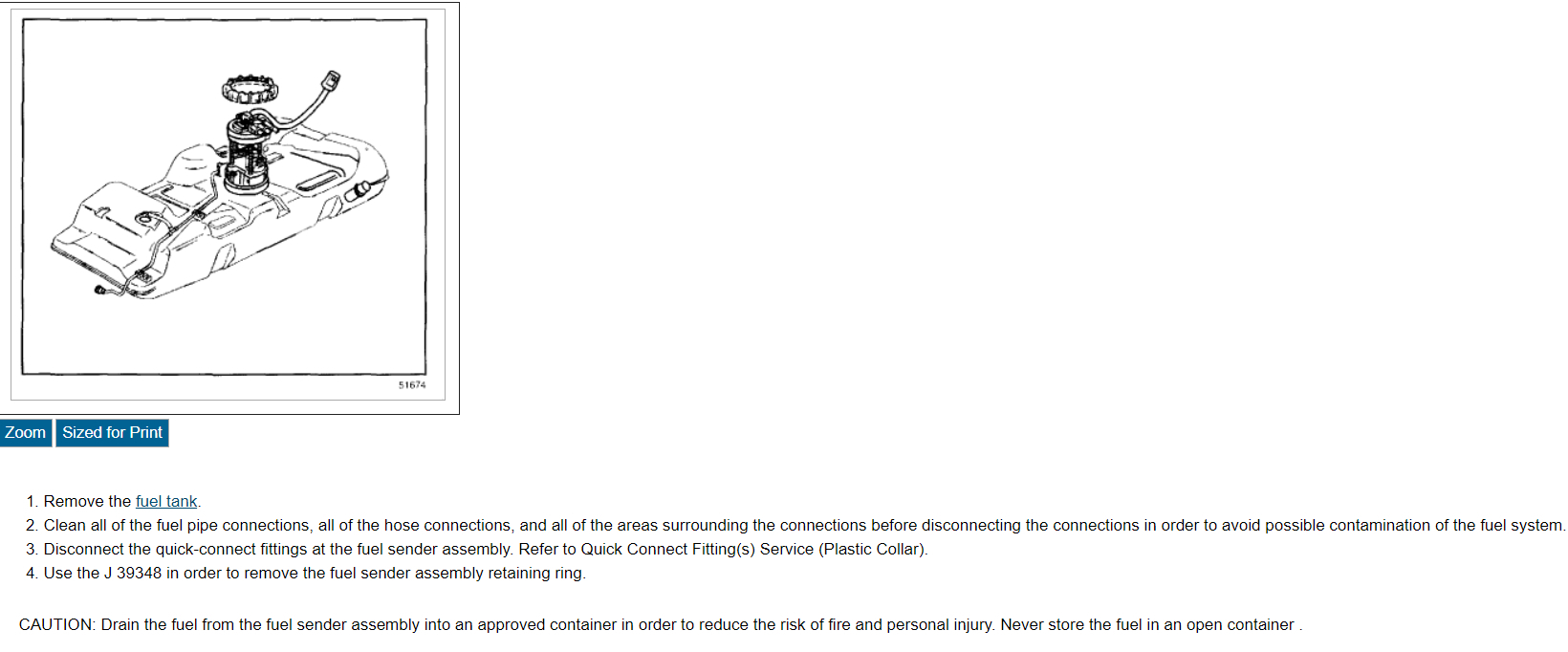

Where is the fuel filter located I need to replace it?
2008 PONTIAC MONTANA
128,000 MILES • 6 CYL • 2WD • AUTOMATIC
ABBROWN43
My van was running fine until yesterday, it stalled out at a red light seems to not be getting fuel. The fuel pump is working fine. Just can't locate the fuel filter.
Feb 5, 2020 at 5:58 PM

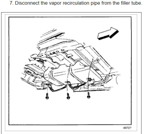

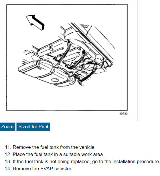

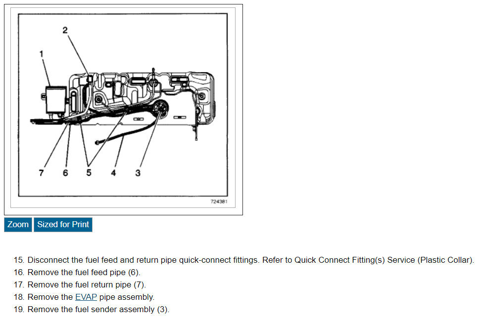

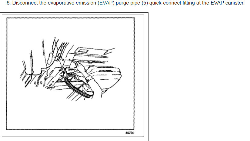

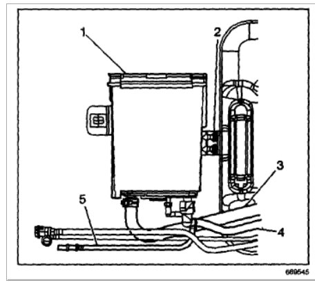

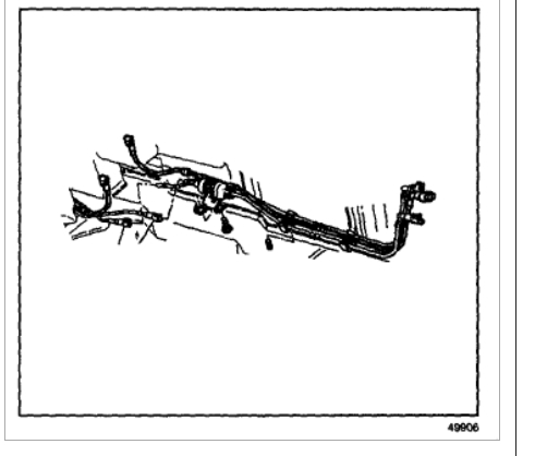

Here is a guide to help walk you through the repairs with diagrams below to show you how on your car:
https://www.2carpros.com/articles/how-to-change-a-fuel-filter
Check out the diagrams (below). Please let us know if you need anything else to get the problem fixed.

My wife recently had an oil change done on our van. The guy doing the oil change asked her if she wanted the fuel filter changed and she asked over the phonme and I said no. He told her that the filter should be changed periodically because if it is not, then the guage could stop working. Coincidentally, our guage has stopped working well before this point in time. Now, I would not believe what this guy said to be true but could it be or is this a coincideance? Anyways, We did buy a filter and I am having a hard time finding where it is located under the van. Doea anyone have any info on changing this?
Oct 7, 2020 at 11:22 AM (Merged)
BLUELIGHTNIN6
  • 16,542 POSTS
A dirty fuel filter has no connection at all with the gauges. The fuel sending unit is what controls the gauge and it is located in the fuel tank and requires no regular maintenance.
Your fuel filter is located about 18" to the front end of the fuel tank on the inside of the frame
