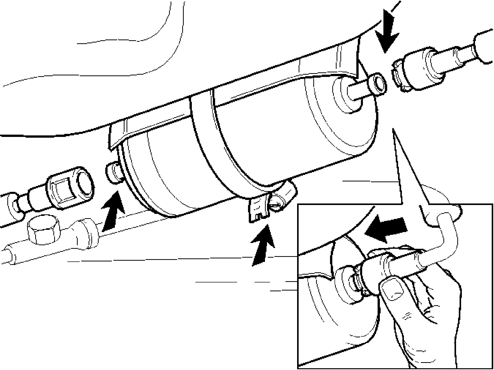

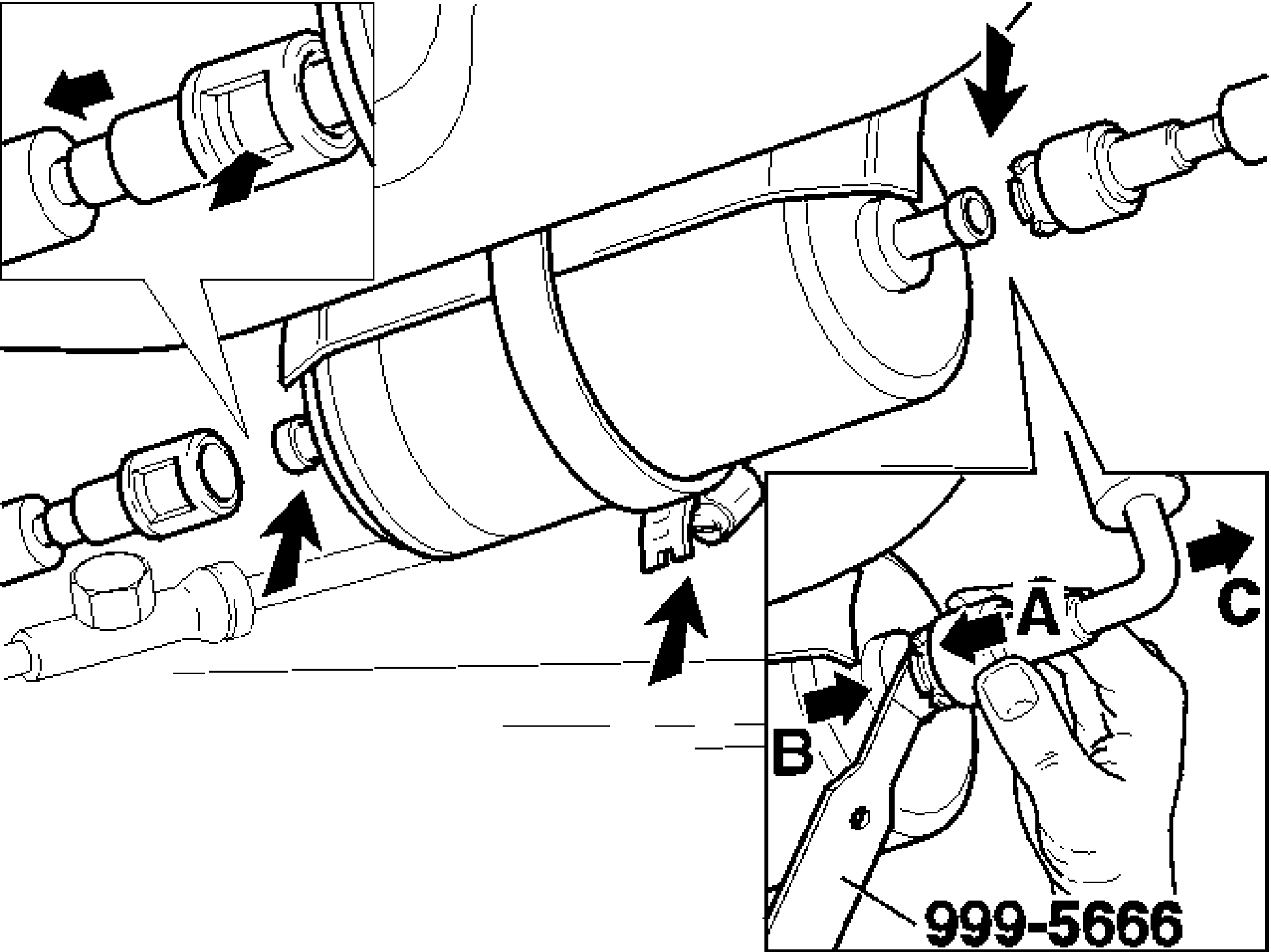

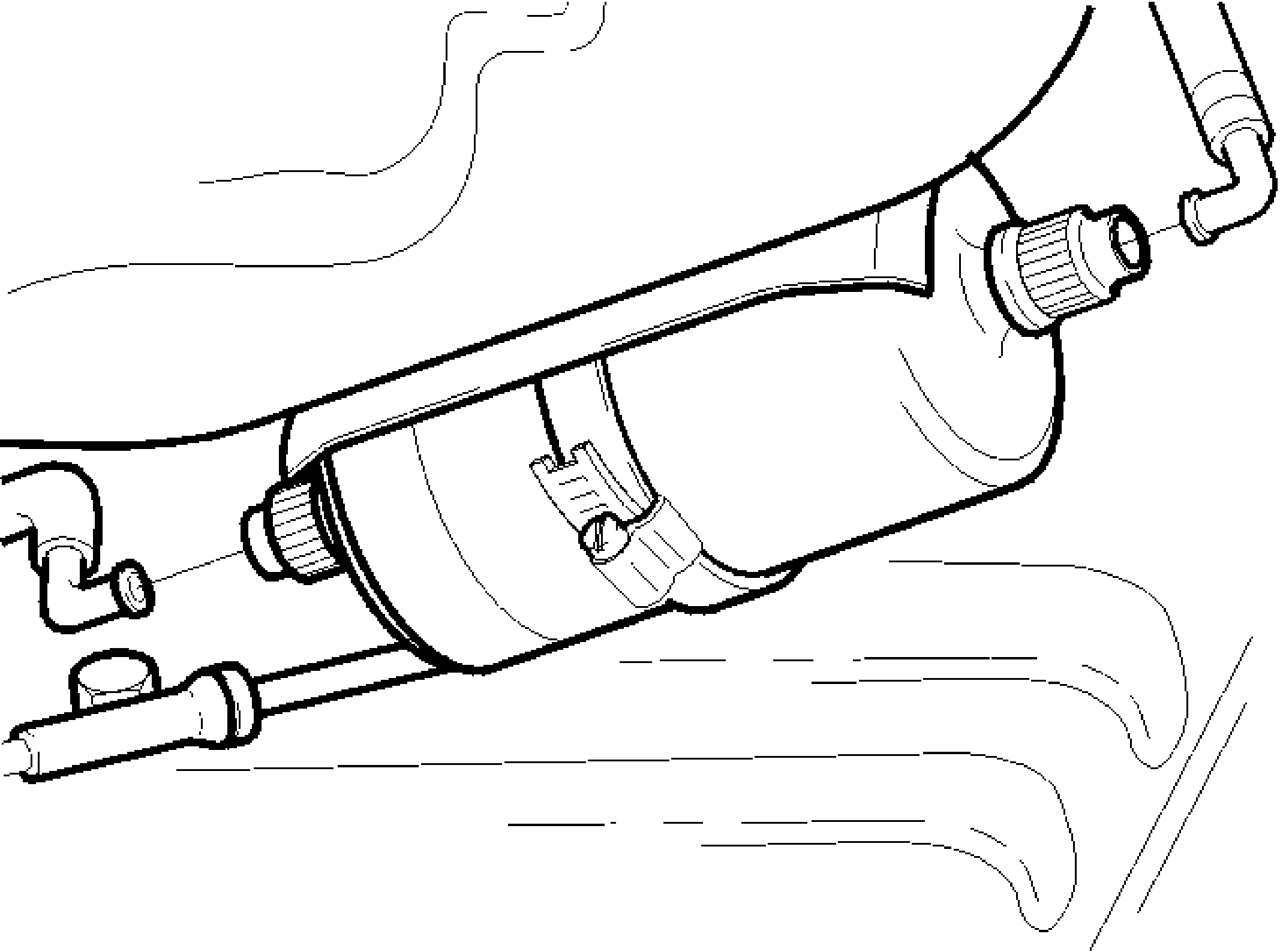

Here are the directions specific to replacement for your vehicle. The attached pictures correlate with these directions.
________________
REPLACING FUEL FILTER
Replacing Fuel Filter
Special Tools: 999 5666
Draining fuel system
- Drain fuel system according to Draining the fuel injection system.
Removing fuel filter
Front side:
Carefully release the quick-release connectors by pressing the fuel lines towards the filter (A) while moving the black circlip backwards (B), together with the fuel line. Use tool 999 5666.
Rear side:
Press the fuel line locking part in and pull the fuel line off.
Remove the clamp and remove the fuel filter.
Installing fuel filter
Install the new filter and carefully reconnect fuel hoses. Check that the quick-release connectors are secure by pulling them.
Secure filter on the bracket with the clamp.
Start the engine and check for leakage.
Removing special tools
See draining the fuel injection system.
