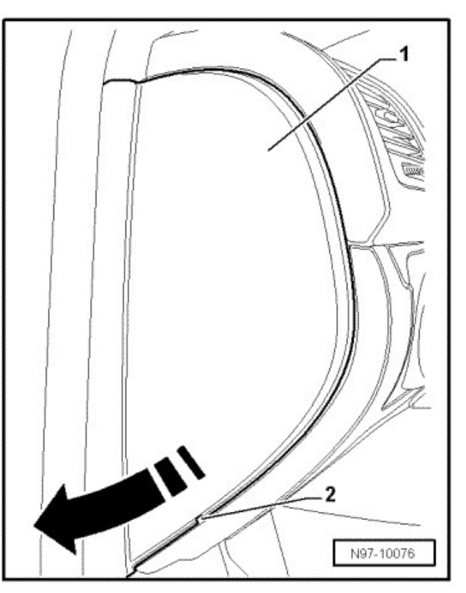

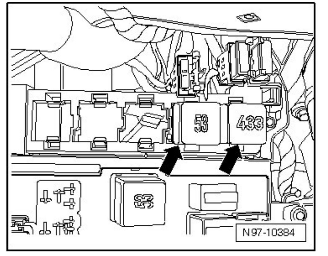

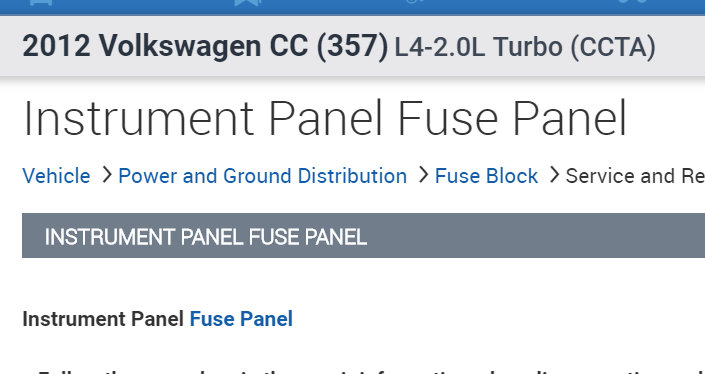

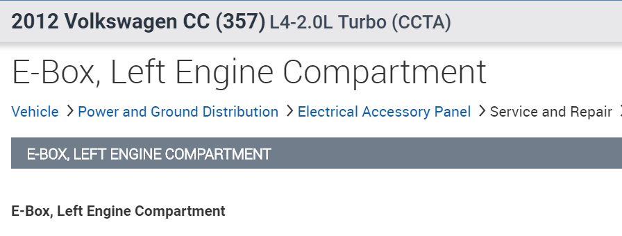

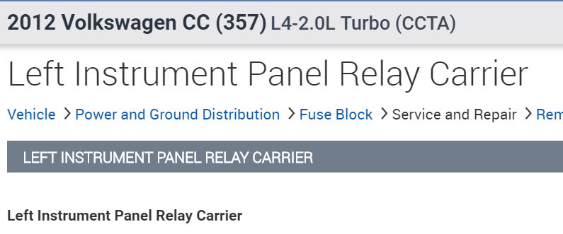

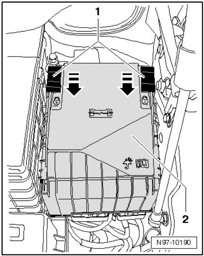

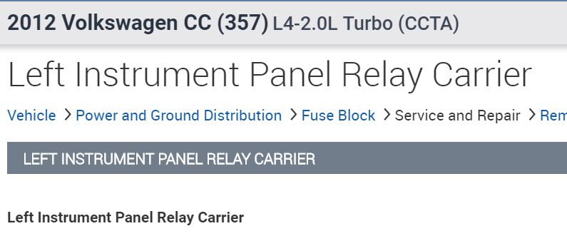

I have put the location and description of the three fuse panels/relay blocks in the diagrams below. I hope this helps.
