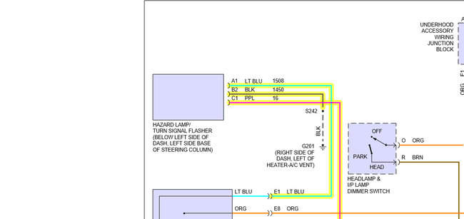

The book says its at the lower left side of the steering column. A quick way to find it is, if the left turn signal is still working, turn that on and listen for the flasher while you are under the dash. It should be a small like plastic box with three wires coming out of it (a lite blue, purple, and black) and it should be making a clicking noise while the left blinker or hazard flasher lights are on. Hope this helps.

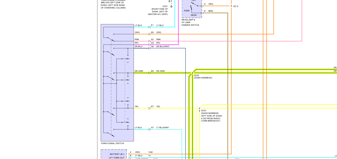

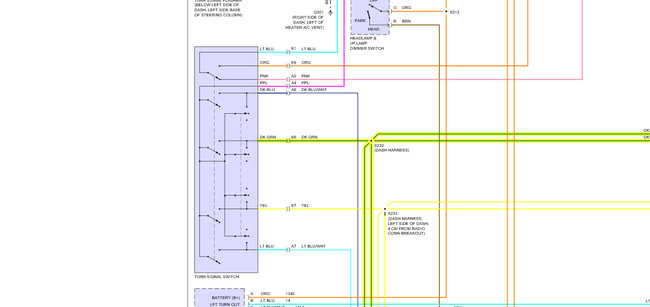

But after looking at the wiring diagram, it cannot really be the flasher I am sorry too say. If the flasher was bad neither signal would work. It looks like a bad signal switch or wiring to from the switch. Try the hazard lights and see if those work.
But they are all controlled by the same wire, so the only real test is to see if you have power coming out of the switch on the steering column. It is a dark green wire coming out of the switch, it is highlighted in yellow on this wiring diagram.
